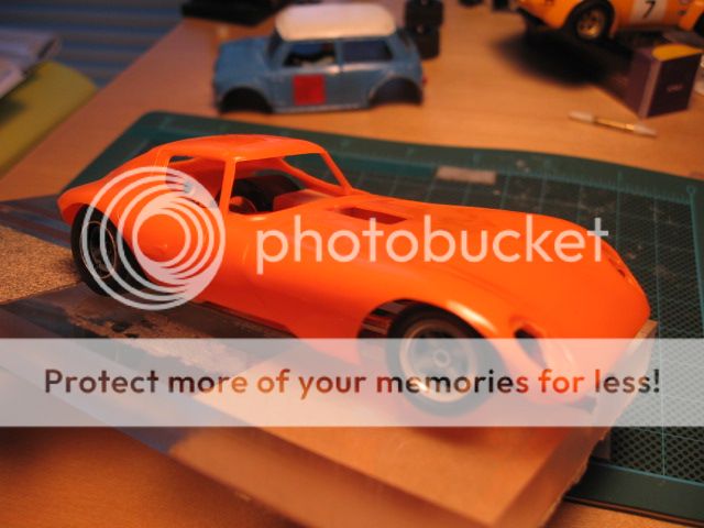

Luf passed a Strombecker Cheetah body to me. I didn't have a chassis ready to go so I thought about re-bodying one of my built cars. Turned out the adjustable wheelbase one from one of my Minis fit the bill.
With new body mounting posts and lengthening the adjustable wheelbase, it worked out fine.
Larger wheels/tires are more appropriate but I sort of like this low profile look.
Modeling work to come.
Dan

Postby dreinecke » Sat Jan 09, 2016 11:32 pm
Good looking car - the chassis should make that thing fly.

Postby Retro Racer 44 » Sun Jan 10, 2016 12:44 am
Looks good Dan, now you will need the side pipes again. If you do the flares again on this one, and make a mould, I'll want a copy. Please!

Postby Czar » Sun Jan 10, 2016 8:46 am
When I read the title I'll admit I was scared. But, nice job. I mean no offense, that hue of orange and the perspective in the last photo make it look a little bit like a Manta Ray.

Postby acmost » Sun Jan 10, 2016 9:03 am
All hail the Cheetah...love that chassis.

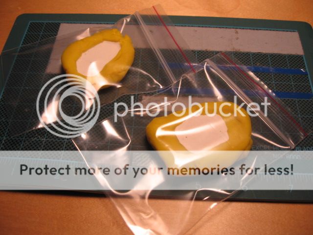

@ Shotgun - to vacuform the windscreens, I made a male plaster plug by:
- pressing the original screens into Play Doh modeling material to form an impression and carefully removing them.
- mixing Plaster of Paris and pouring into the impression.
- waiting 24 hours for it to dry and voila.
- clean surface imperfections with a fine sanding pad.
The vacu forming was the easy part when you've got access to this beauty of a machine.
Thanks Luf.
Lessons learned.
- Let the plaster dry completely before handling.
- Wet the Play Doh mold before pouring in the plaster.
- Don't try to save the Play Doh in a baggy. Just let it dry out on the work table.
- Make the plug about a 1/4" thick. Not too thin so the mold will crack when the PETG is sucked down and not too thick so it's hard to remove.
My first try on the Toyota S800's windscreens turned out better. I actually left the windscreens in the mold and poured plaster into that. Plug came out cleaner and subsequently the windscreen pops.
Hope this helps.

Postby JT Previa » Sat Jan 16, 2016 11:07 pm
Cheetah Ray!
(as noted by Czar: lots of Manta Ray in that car.) Similar to a Chip Foose retro renovation too.
Are you/can you move those front wheels back a bit to better inhabit the wheelwells?
