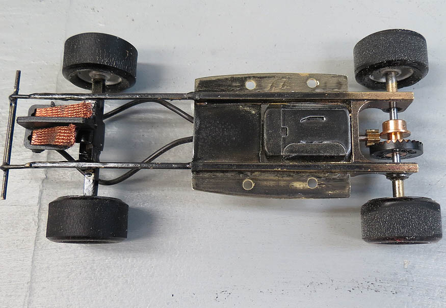

I'm just gonna' copy your chassis for mine.Is this a bomber or are you keeping the tires inside the body?

Nice looking chassis, I might have to build one myself and put it under a Cuda or Challenger. One can use a tie tack to hold the wires in the center of the chassis. Simply solder the tie tack in the middle of the chassis approximately where you taped them down then pass the wires through the round eyelets and the the wires are secure until you want to remove them. We used that method on the 1/24 scale steel chassis on the commercial tracks. Also if you make the wires about the same length ahead of the tack it will create the same tension and help center the guide which makes it easier to put the car back into the slot when marshaling. Cool build!!!!

Also might want to put a couple of Parma or Slick7- 1/8 steel washers between the copper shim tubing and the bushing. Steal washers won't wear like the copper tubing, plus when lightly oiled the will work like a generic bearing.

Thanks for the info. I just got lazy and used tape, but that is a very ideal way.
These are 3/32nd axles. I used thin shims Slot Car Corner makes in between the tubing and bushing for that reason. I should show that.

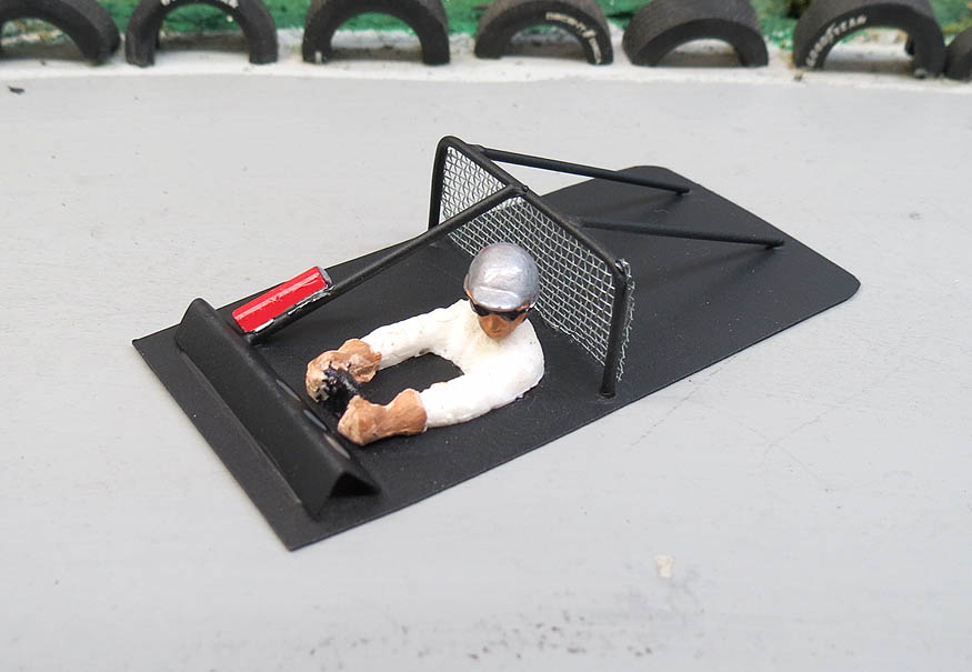

The interior is flat tray type, made from a playing card.
MT Resin driver figure, roll bars made from Evergreen rod. Little screen added of course.

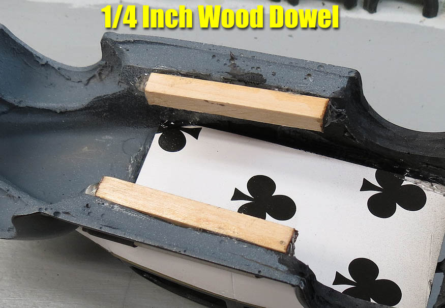

I decided to use a different mounting approach. Dave Dobner taught me this trick and it really works. Used some 1/4 square dowel rod and JB Weld. Little super glue in the seam for good measure.
Drilled the mount holes in the side pans, then mounted the body on the chassis. I hot glued it to hold it steady and then used a smaller drill bit and drilled the holes into the wood.
I set the front and rear track width at just under 2 1/4 inches. I wanted that wide look on this car and it worked well enough.

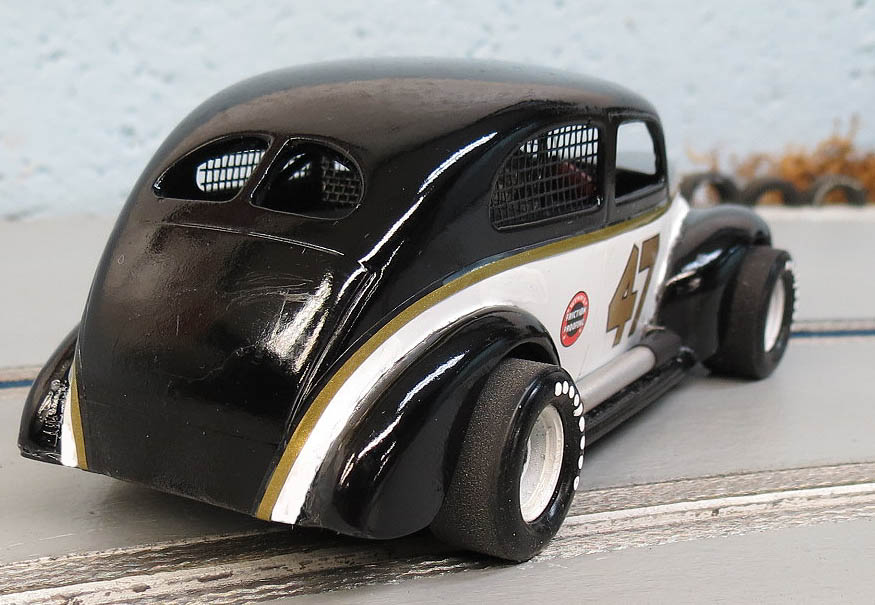

All in all this was a lot of fun! Dave made a real nice body and now I finally have that big old sedan in 1/32.
