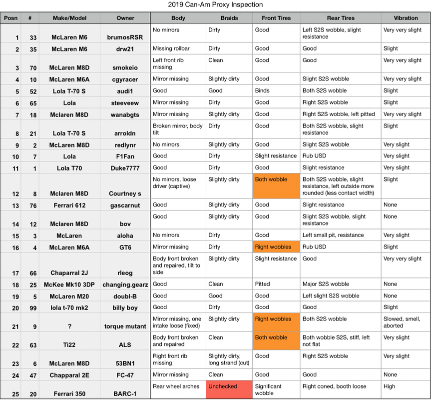

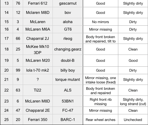

Inspection
Postby AndGoliath » Tue Oct 01, 2019 5:36 pm
Here are the cars in no particular order:
Alan and I checked out the cars and this is the report:
Body: I listed anything that appeared to be missing or damaged. Most damage was previously repaired. Alan glued an engine intake back onto one car.
Braids: I checked whether the braids were clean or dirty. I cleaned the brushes with a clean toothbrush with a ruler backing them up so they would not get flattened.
Front tires: I spun them to check for wobble and resistance. I will recheck the highlighted ones tomorrow to determine whether it is side-to-side (S2S) or vibration inducing. All of the axles turned (no dragging). One of them stopped immediately (#52) and a couple (#77 and #66) would spin a little more.
Rear tires: I spun them to check for side-to-side wobble and resistance. Any resistance noted appears to be motor feel, not binding. I did not have enough light to see any out-of-round wobble. The vibration check should cover that.
Vibration: I ran each car on a roller stand (at 10V) with a toothpick on top to determine the subjective amount of vibration. This needs to be taken with a grain of salt since the flat fronted cars did much better.
While doing the vibration check for the #9 car it slowed as I was adjusting the voltage indicating it was increasing its current draw (my train supply operates more as a constant current than constant voltage supply). We stopped the run and removed it. It had a bit of a smell as if it was overheating. There was no binding. We checked it again at the end of the checks and it was fine. It was also fine during the low speed lane checks. We will check it again before, during, and after qualification.
We did not open any of the cars up. The cars that have "open" rear ends did not appear to have any significant build-up inside.
Alan and I ran each of the cars slowly around the track in each lane to ensure there was no binding. Thanks to one illegal guide (it sticks out beyond the front of the body) we found a couple of paint drops in the slots that were removed.

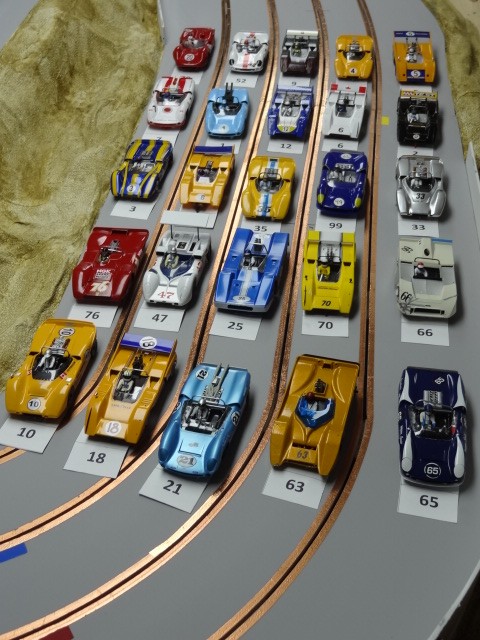

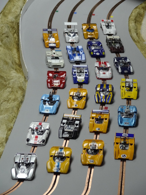

I am first sharing some pictures to tell the qualification story. The first two indicate the qualifying podium and order:

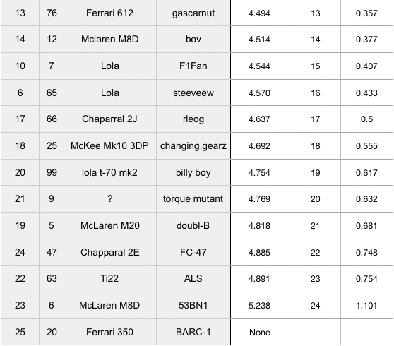

Postby AndGoliath » Wed Oct 02, 2019 2:37 pm
Here are the qualification results:
Notes:
1) The cars were qualified in reverse order of their position in the standings (left-most column).
2) Each car was run for one minute in the blue lane (second from outside in the long sweeper) and its best lap recorded.
3) There were relatively few offs (5 or so) when I braked too late after the sweeper and only one car gently bumped the newly padded barrier (#70, I'm sorry about that).
4) All cars were able to take the sweeper at full throttle.
More information is to be provided in the driver feedback.

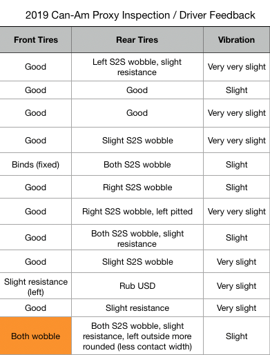

Postby AndGoliath » Wed Oct 02, 2019 2:54 pm
Here is the inspection / driver feedback from qualifying:
Legend:
Sound: This is the nature of the sound the car makes when it is driven. "Drag" means it sounds like it is dragging (it is not necessarily doing so). These sounds are probably related to how the bodies are attached. My RevoSlot is the only car I have that makes a lot of noise so I do not have a lot with which to compare.
Braking: This is how strong the braking action. This type of circuit needs brakes since there are alternate high-speed / low-speed sections. Also, if the car did handle well in low-speed corners and the car had poor brakes, then it was necessary to go off-throttle earlier to compensate.
Low-speed Cornering: This is the degree of oversteer in the 180* corners and the S section. "Tight" means the car was on rails. "Loose" meant it was oversteering more so than the easier to handle cars. The ability to recover indicated less oscillation and the ability to get on the throttle quickly to go into the sweeper (the track has a slight jiggle exiting the 180* corner before the sweeper and being able to recover quickly helps get the power down sooner). The #70 car was the only one that tended to break loose and stay out the whole corner and accelerate in a controllable manner.
High-speed Cornering: I wanted to provide an indication of this, but I did not have a good view of the cars from my driving position due to the overpass. As the cars came into view I was more concerned with braking points. Some drifted a bit, but there was no oscillation that I could see.
Speed: This is a subjective measurement of the relative speed of each car. The label "more capable" indicates it felt as though the car could have handled more speed around the sweeper if it had the speed. All cars were driven at full throttle around the sweeper. All cars except one seemed to accelerate well. I noticed #5 did not pick up speed as quickly. Obviously, the final speeds differed.
If there is something that does not make sense, please ask for clarification.
