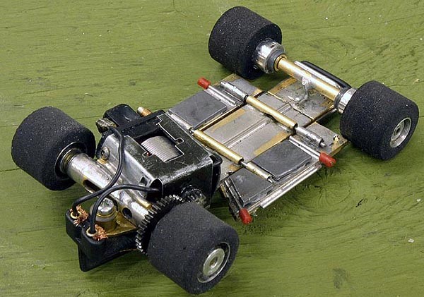

Lots of guys in the BSCRA (British Slot Car Racing Association) have built front drive cars (the BSCRA has had many front drive classes over the years), and the following pics. are of a couple of the more successful builds (according to the race reports in some of the older British slot magazines)
Chris Walker
Both of these chassis are anglewinder configurations.......the main reason being (and the reason the anglewinder configuration came into being ) is that the anglewinder allows the use of a small dia. pinion/spur which permits a high numeric gear ratio, while equally importantly, allowing smaller dia. wheels/tires.
Secondly, note that both chassis utilize rear tires that would offer good rear end grip (both of these cars use sponge, and these would have had added grip through castor oil/oil of wintergreen etc.)..............while treated sponge tires are not the "norm" for the type of racing most of us do, it is nonetheless important for a front drive chassis to have plenty of rear grip. I have done maybe a half dozen front drivers over the years, and the best ones all had good rear grip.

@ zcar-fan - I've just been using pliers, a broad and needle nose. My main rails are .055" piano wire and are bendable with a bit of grunt and making sure that one end is securely held with a plier.
@chrisguyw - thought it'd keep the rear tires sticky so good to get confirmation. Your first pictured chassis is a beauty and my understanding is that it fits under a Scalextric 1/32 Clubman body. Great effort to make that fit in such a small car.

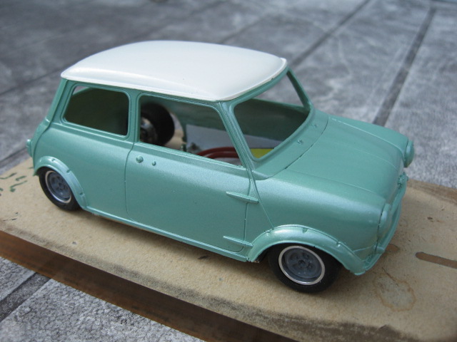

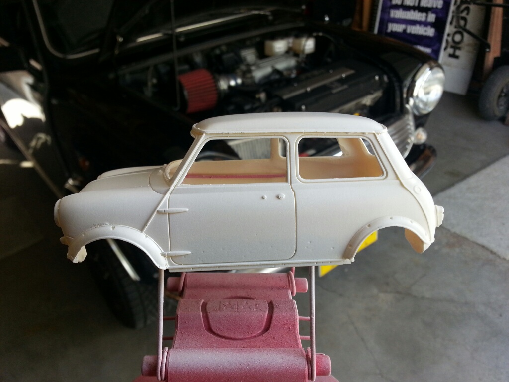

Summer's winding down with driving and working on my 1:1 Mini, so that's spurred me on to finishing one of my two slot FWD Minis.
Tamiya fine white primer is on my resin body.
Spraying the roof a TS-7 Racing White finish with the body in TS-60 Pearl Green and then an overall pearl clear.
Going with my first fwd chassis, the sidewinder. Put on some fresh urethane tires, trued down versions of Ninco F1 fronts, mounted on BRM 14" Nascar rims.
Mounting system's screwed on Plastruct L channel with double-sided foam tape on the vertical face attaching to the body.
Dan

Postby VTECFOUR » Sun Sep 15, 2019 10:46 am
Color combo worked as hoped.
Final body stance will likely be higher to ensure wheels/tires turn freely. Got steel wheel inserts in place but rose petals are the final choice.
Paint detail to come.
