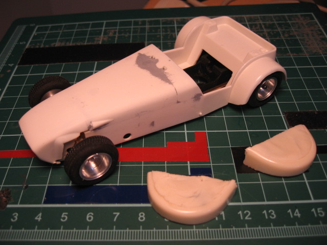

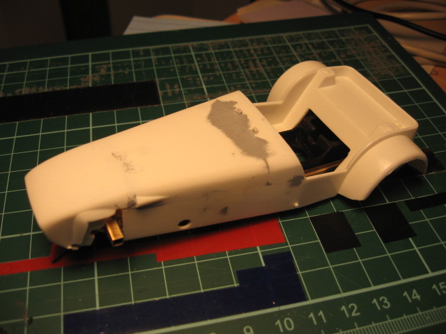

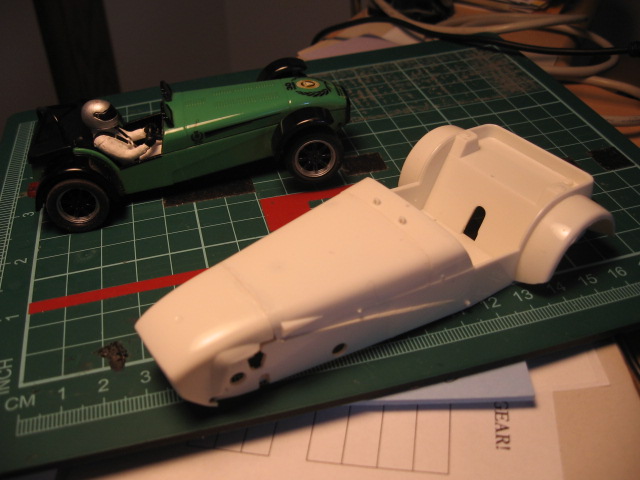

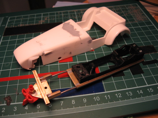

The first build worked out well, so another's in order. This time with cycle front fenders. More out of necessity as the used Tamiya kit body already had one of the sail-like fenders cut off.
Sawed off the remaining fender. Cowl, bonnet and nose glued and epoxied together in preparation for the chassis, one of my adjust-o-wheelbase ones. The 1/32 Scalextric Caterham, one of my favorite slot cars, is a good reference for this larger version.

Postby VTECFOUR » Mon Jul 30, 2018 2:28 pm
Body shell's trimmed to fit the assembled chassis.
Going with the same wheel/tire combination as my build 1, RS Slot Racing RSW002 rims/PG 22073 tires.

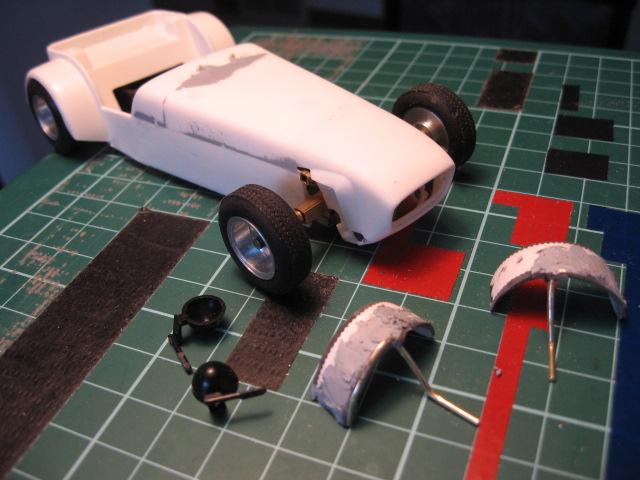

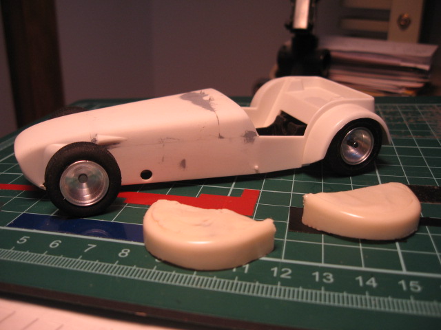

Postby VTECFOUR » Tue Jul 31, 2018 10:29 am
Wheels/tires mounted and body mock-fitted.
Got some resin fenders off one of my Aurora 32 Ford sedan casts.
Need modification and a mounting system but at least they're the right diameter and have a rolled edge.
Dan

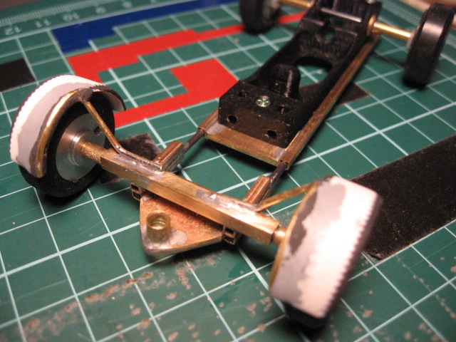

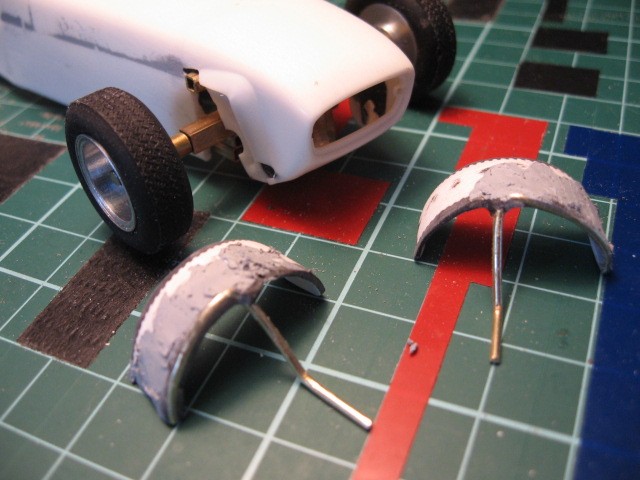

Postby VTECFOUR » Sat Aug 04, 2018 12:05 pm
Some progress on the front cycle wings and head lamps.
Abandoned the resin ones and severely modified old plastic kit tires with bent 3/64 brass rod for support. Rods will be soldered on the front axle square tube. Fit will be fiddly to sit just above the tires and not rub.
Epoxied in a 3/32" square brass tube above the axle to hold the kit's headlamp assemblies.
Dan

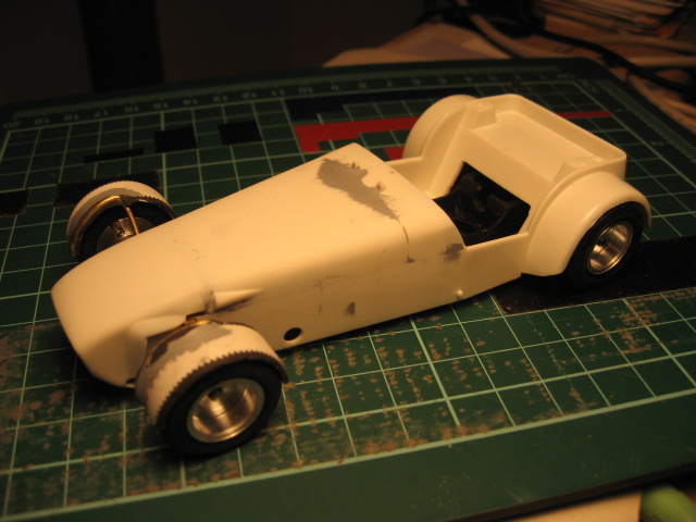

Postby VTECFOUR » Sat Aug 04, 2018 8:55 pm
Wings positioned and stays soldered in.
Tires rub just a bit so out come the files.
Dan

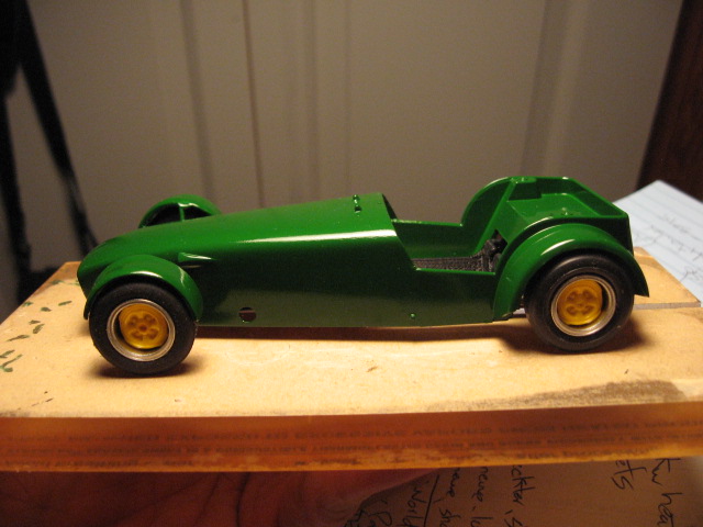

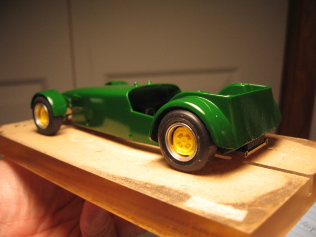

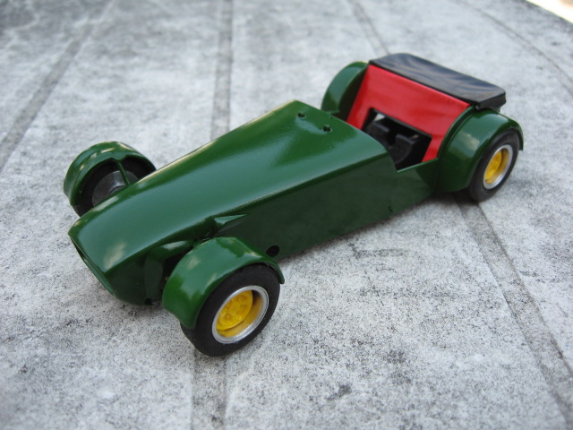

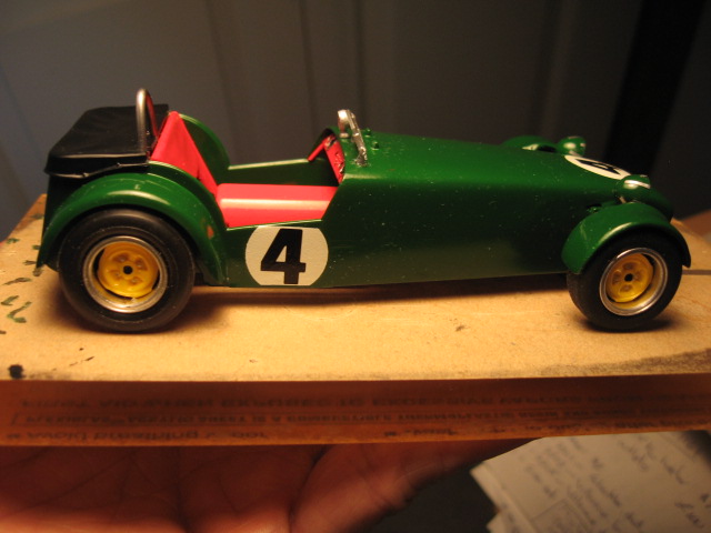

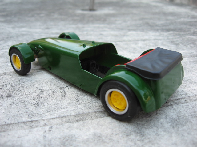

Postby VTECFOUR » Tue Aug 07, 2018 10:59 pm
Spray-primed body pieces with Tamiya Fine Grey followed with Tamiya TS-43 Racing Green.
Wheel inserts are my resin copies of the kit's trimmed-down steel rims.
Pleased with the look.
Dan

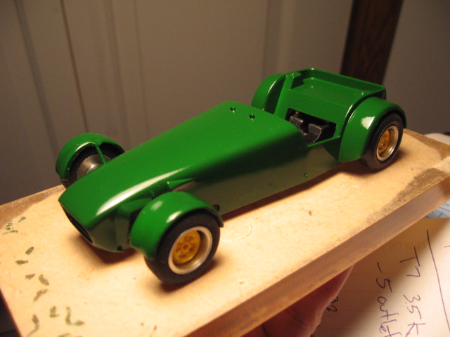

Postby VTECFOUR » Wed Aug 08, 2018 1:30 pm
Was thinking of painting the nose, yellow, but with the red interior that helps my desire for more color contrast.
Dan

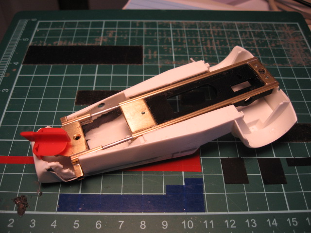

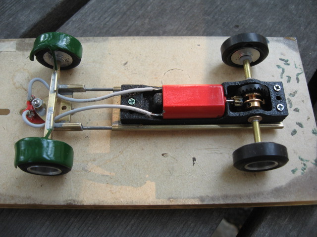

Postby VTECFOUR » Thu Aug 09, 2018 5:41 pm
Chassis's rolling. Drivetrain's a Scalextric Sport FF050 21K motor with BWA 9t pinion and Slot It 27t crown gears.
The guide's my usual choice of the Scale Auto SC-1604 Universal Home, 7mm blade but something unusual cropped up. The shaft is larger than 9/64" as all the previous renditions have been. Is this a one-off or has Scale Auto changed the spec?
Nice thing about 1/24 small car builds is that the same chassis can be used that I construct for 1/32 cars.
Dan

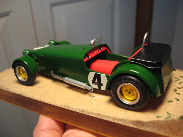

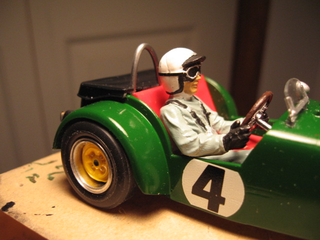

Postby VTECFOUR » Fri Aug 10, 2018 4:43 pm

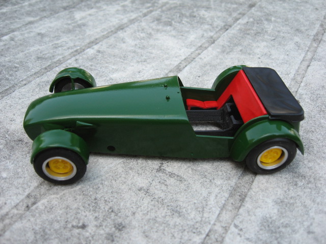

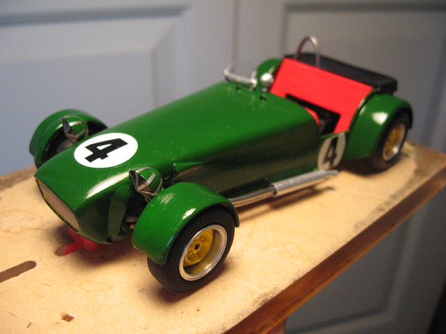

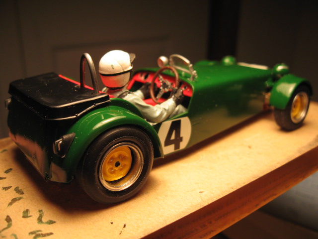

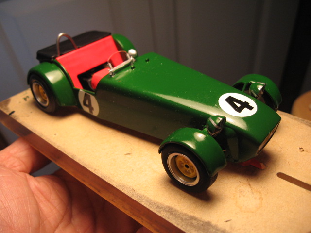

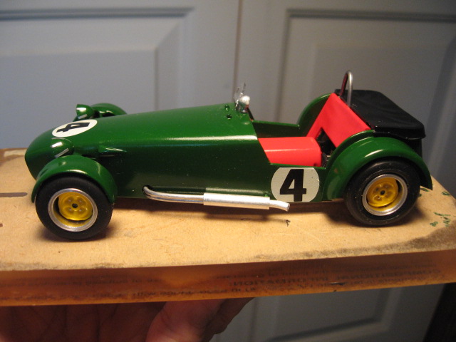

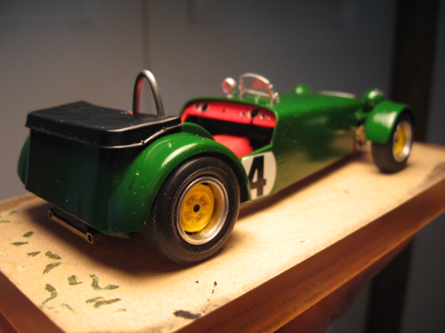

Did some modelling detail work.
- wheel inserts and instrument panel paint detailed
- Brooklands screen and mirror painted
- headlamps (missing chrome and clear lenses) filled with epoxy and taped over
- nose screen (missing from kit) cut from fine mesh and surround painted in a yellow accent
- rollbar hoop bent from 1/16" piano wire
- roundels decals applied
- exhaust fabricated from 1/16" piano wire and sleeved aluminum tubing (5/32", 1/8", 3/32")
Definitely helped mute the green body finish.

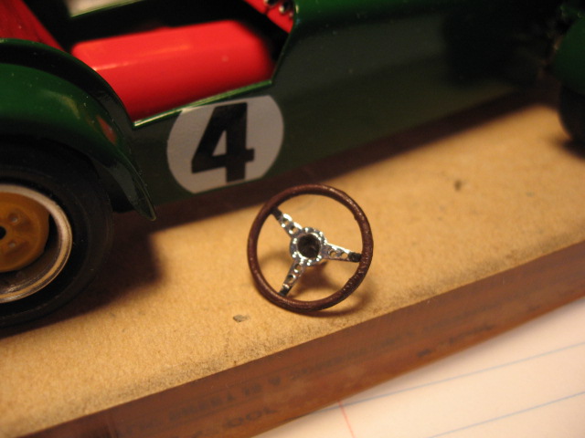

Don't have the right driver figure handy so the steering wheel mounting will wait for that.
Runs fine too so we're pretty much done.
Dan

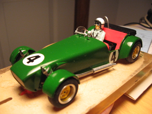

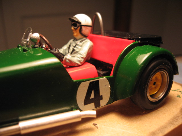

Postby VTECFOUR » Fri Aug 10, 2018 11:45 pm
Went through my 1/24 kit assortment and found a nice driver figure in the Monogram Chaparral 2D.
Sits nicely in the 7's seat at the right angle. Removed the left leg and sanded the arms to clear the motor. Paint detail was icing on the cake.
Now we're done.
Dan
