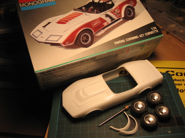

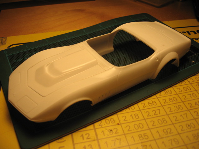

Liking the bigger scale more and more, so got this Monogram kit out of the closet and gathered running parts.
BRM Trans Am rims and tires match the kit's wheel/tires diameter spot on. With a little filing, the wheel insert will fit right in.
The engine hood and rear flares fit well and were glued to the body.
Would like to try a hybrid sidewinder chassis on this one.

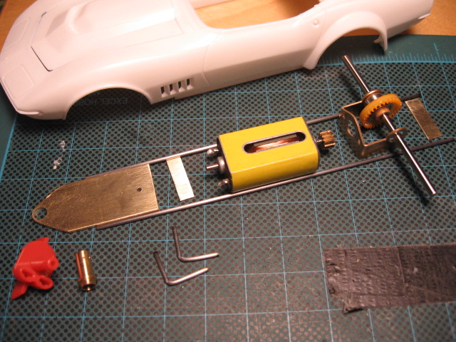

Cut and gathered pieces for an inline ladder-type chassis.
- .055" piano wire for main rails and front axle uprights
- .032"x .75" brass strip for rear and middle crossmembers
- .064" x .75" brass strip for guide tongue
- Slot It 20.5k Flat 6 motor
- Slot It 10t pinion gear and Plafit/Sigma 30t crown gear for 3mm axle
- Sloting Plus 3mm axle
- Sloting Plus 3mm rear axle bushings.
- JK F1 motor pod (.75" wide)
- Scale Auto universal guide with Samson guide post
Should be together soon.

Postby TuscoTodd » Fri Mar 08, 2019 7:28 am
Great to see the "parts list" associated with the build!
Looking forward to seeing it's progression!

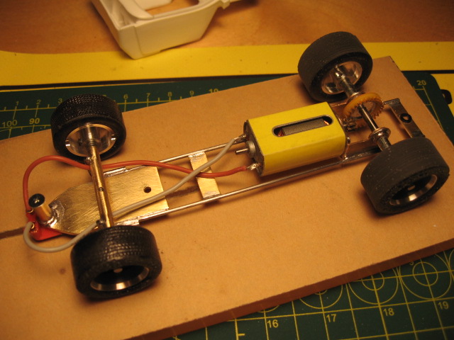

Basic ladder chassis pieces soldered together.
Getting some 4mm brass tube to accept the 3mm (.118") front axle.
Could use 5/32" tube with an inside diameter of .125" but rather minimize any slop.

Postby VTECFOUR » Wed Mar 13, 2019 12:22 pm
Chassis's rolling.

Postby VTECFOUR » Thu Mar 14, 2019 10:52 pm
Running chassis's assembled.
Crown gear was a real tight fit. Required installing the bushings with the thin flange on the inside and reducing the width of the gear's boss.
Worked out so there's no rubbing.
In tight corners I could see the front tires hopping. They're pretty wide so a coating of Sally Hansen's Hard as Nails, Invisible 109 nail polish cut down the friction and eliminated the hop.
