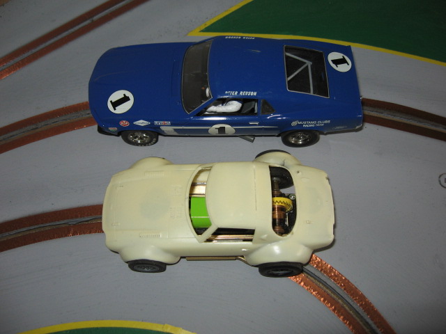

Postby VTECFOUR » Wed Dec 26, 2018 8:02 pm
Chassis's rolling, powered by a Scalextric Sport 25k motor and geared with a BWA 9t pinion and Slot It 28t crown.
Runs just fine.
Mocked the body on.
Looks pretty close to the final stance.
Body mounting to come and then wheel arch filing and tire trueing.
Dan

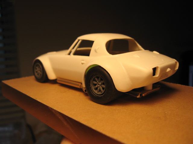

Postby VTECFOUR » Thu Dec 27, 2018 2:15 pm
@FC47 - I always use FF050 slimline motors for my small car builds. Alongside a Scalextric Mustang, you get an idea of the size and room you're dealing with.
This particular 25K motor is a bit of overkill but that's what I had in the parts bin. The fat rear meats are over the top too but it works for me.
Body's mounted now with just enough wheel arch/tire clearance.
On bodies that have some fender flare to spare, I mount the body right down so tires are touching and THEN file for clearance. Works well when the circumstances allow.
Moving on with body cosmetics.

Postby FC47 » Thu Dec 27, 2018 7:23 pm
That is a tight package, are those the 761 tires on it?
The shots you posted helped. Made me think. Folks posted about plastic spoons for flares, I took one of those pop open plastic Easter eggs, bandsawed each half...got em cut down carved and fitted close to what I want...ways to go but on the way...
Thanks for posting the builds!

Postby VTECFOUR » Fri Dec 28, 2018 4:24 pm
@ FC47 - Yep, those are urethane copies of the Fly March F1 rear tires. Really like the bulging sidewall detail on these.
Sprayed on Tamiya fine white primer on to reveal the body deficiencies.
Final paint will be white with blue on the front and rear valences, hood and rear deck.
Front and rear tracks have been narrowed to better tuck in the tires.
Coming along well.
Dan
