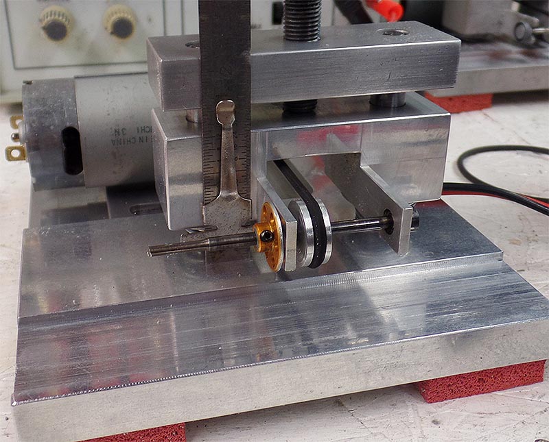

I give you the Razor Pro, the best truer for the serious racer.
First off lets just make this clear, the Pro will ONLY TRUE ALLUMINUM SET SCREW WHEELS
You can NOT TRUE AXLE SET'S ON THE PRO
The Pro comes ready to true 1\24 or 1\32 The wheels are held by a Nitride harden ejector pin, the ejector pin spins in sealed flanged roller bearings held in the axle block
The sanding block comes with 2 grits 400-1500
I have one ready to sell and 4 more waiting on pins
This is a limited time only, first come first served, you can only get the Pro from me here on HRW
Price is $185.00 Shipped to all 50 States
Price is a little more than your standard Razor but only for the added Ejector pin and Sealed Flange Roller Bearings
THIS TRUER IS ONLY FOR SET SCREW WHEELS

Are the sanding blocks meant to be in that orientation (full flat side up)? I thought that the full flat side was meant to be in the down orientation and that the sanding pieces were meant to be on the two raised sections (?)
Truing one side at a time, how can you be sure that both tires have the same diameter when you're done? Do you have to mic them? If so, I've found that micing tires can lead to tired of slightly different diameter. So, how does this work?
Anyway, the new Pro looks very nice!

I do two tires at once but I mic them. To fine tune, I'll finish one by one if need be.I use NSR tires and to get them tru sometimes one won't be exactly as the other

What is the distance from the bearing to the taper of the ejector pin. Recognizing that these are nitride hardened; but wondering about deflection of the shaft, especially at the start of truing process when tire/wheel balance could be worst case.
Great idea...liking the dial indicator option.

Should chime in seeing as I have been testing this rig for about a year.
I use a caliper and my tires are about as even as it gets. Even without calipers you can place one wheel against the other and easily see if they match.
If not, I use a simple machinest ruler against the bottom block. About as accurate as it gets IMHO.

So the tapered pin goes from 3/32 to 1/8 ? I want to be able to true 1 1/16 dia. Pro Tracks,

I put a felt tip mark on the adjusting knob & match each tire to that.
