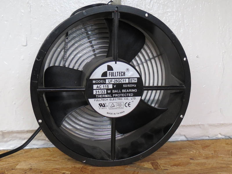

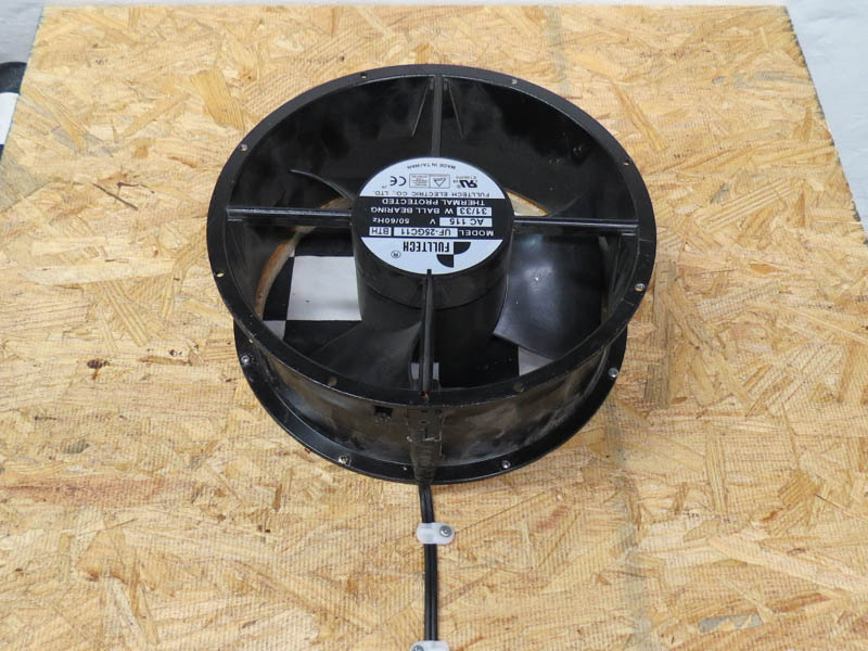

So here is the fan I picked up.
We have a re-sell shop that have all sorts of items from home re-models. It was a $1.25

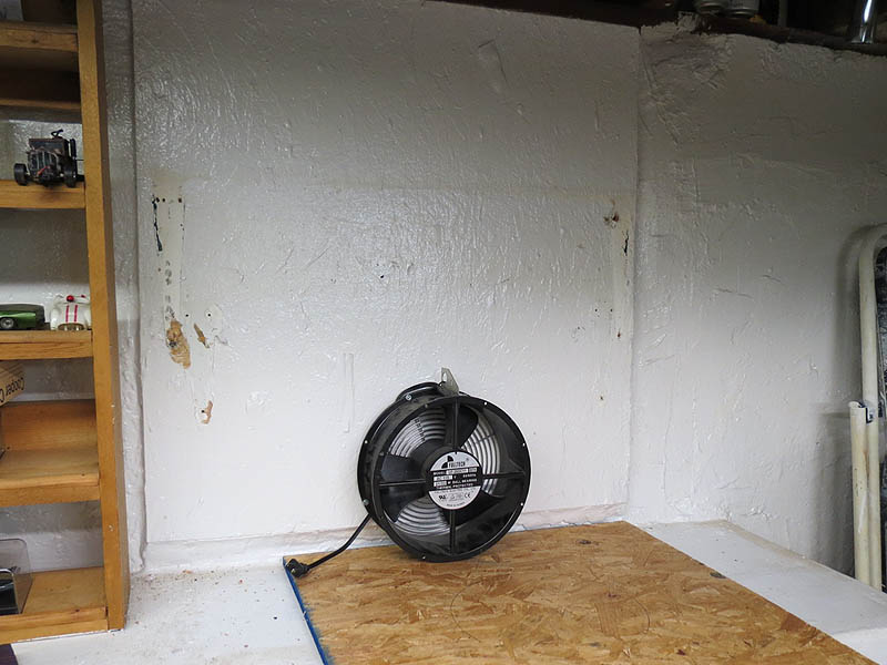

Here the area for the booth. The concrete shelf it sits on is actually what they call a "cap" around here. It was poured to reinforce this old foundation back in the early 90's when the entire house was rebuilt. Now you know why the oval track is so high :)
Behind it was a window. A very poor window as it let cold air in so I sealed it with OSB when I first started to get the mancave ready for racing.
Which is sealed on the outside as well. The vent will be here.

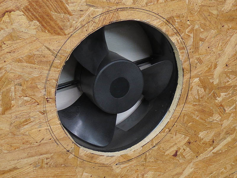

Postby HomeRacingWorld » Sat Nov 09, 2013 10:08 am
Hole cut and fan bolted in.
Getting there.

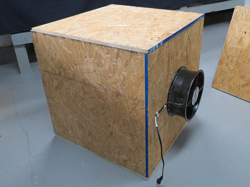

Postby HomeRacingWorld » Sat Nov 09, 2013 9:49 pm
Thanks Dave! Yes, now that it is finished I ask myself why it took me this long to make one.

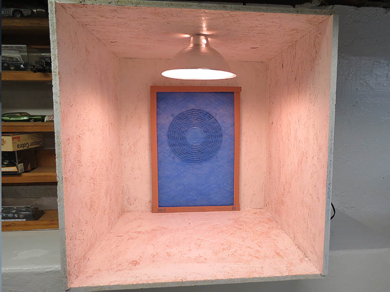

Box finished.

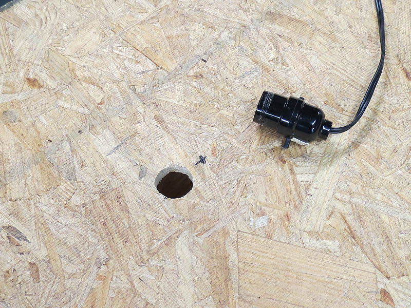

The light is a simple 6 dollar drop/flood lamp from Wal-Mart. I use these for taking photos and they are really are a great little light.
Just cut a hole for the fitting to drop in. Then the metal shade tightens it up nicely.
Still needs another coat to look nicer, but it is sealed and will finish that tomorrow. Other than that, it's done!
