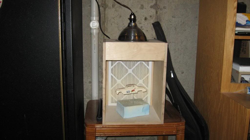

the filter catches the over spray

Having worked with fume hoods in the lab for many years I knew that you get the best air flow if the air does not have to turn a corner, otherwise I might have put the fan intake at the top or bottom. I also wanted to keep the spray away from the light. There was a size limitation imposed by the fact that the chipboard that I had was only a foot wide, plus I wanted the spray booth to be fairly compact. The furnace filter at the back is to keep most of the solids from the spray out of the fan. In my basement I have ductwork that goes outside. If I want to use the booth upstairs I can hang the end of the elephant trunk out of a window.

I agree ,your air flow likely removes the fumes quicker than my paint booth,
I also like the furnace filter at the rear,which can be changed if need be.
Painting in my configuration also leaves overspray on the back wall as you can see.
Whatever we use it's going to be better than what we started with (the box) right !

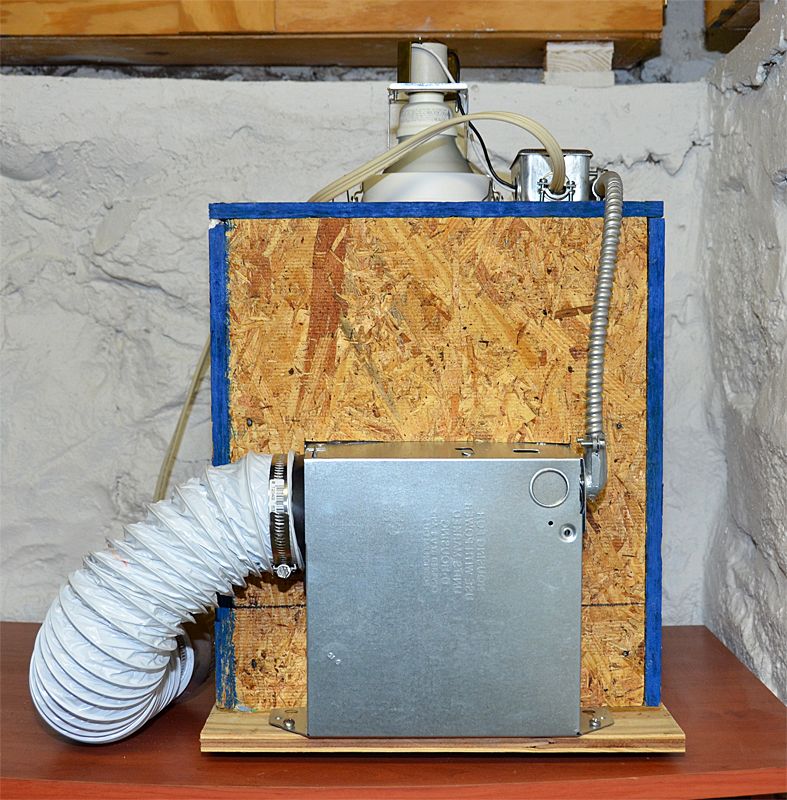

could we get a pic of the back of your booth, to see how the fan is
connected and where the duct work hooks in??

Here you go, you realize of course that I will have to charge extra for this!
The fan housing is rectangular, so it just sits in a rectangular hole in the back of the box and is held in place with four screws. I sealed a small gap between the housing and the box with duct tape. The connection for the elephant trunk is on the side of the housing. At the end of the elephant trunk there is a 3X4 inch adapter so that I can connect it to some existing 4 inch duct work when the booth is being used.

As someone mentioned earlier the power switch could be a possible source of ignition. As long as the fan was running before you started to spray that would not be an issue, however a cautious person might want to seal off the switch enclosure with silicone caulk.
