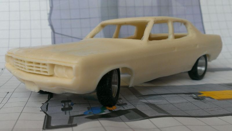

I now work with a local company to do the silicone moulding and resin casting but the biggest cost has always been making the master for the silicone mold. I've used various types of 3D printing, SLA, and FDM but even though my chassis are made with SLS process (selective laser sintering), I've never tried it for a master bodyshell.
However I recently got in touch with a place in London and they said they could make a much higher resolution part than I'd had before. Could this combine the low cost of SLS with the accurate surface finish of the better 3D prints?

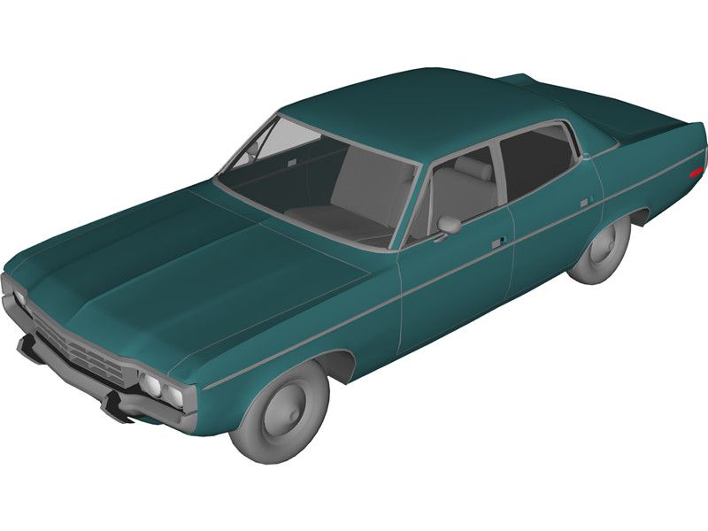

I got the 3D surface data for a 1971 model
Then got a bureau service to stitch the surfaces together so it could be made. Most 3D models have holes in the surfaces where the edges don't quite meet; it's not a huge problem when the car is used in a computer game but it can't be 3D printed like that, the mesh has to be complete.

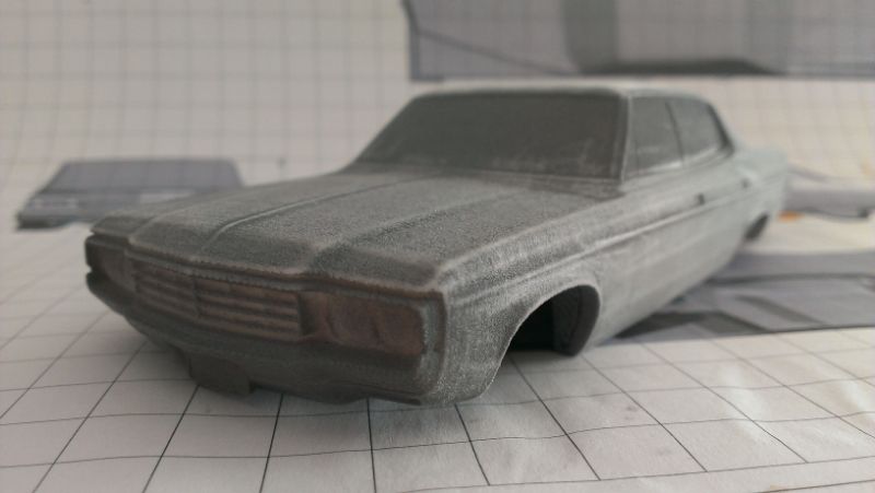

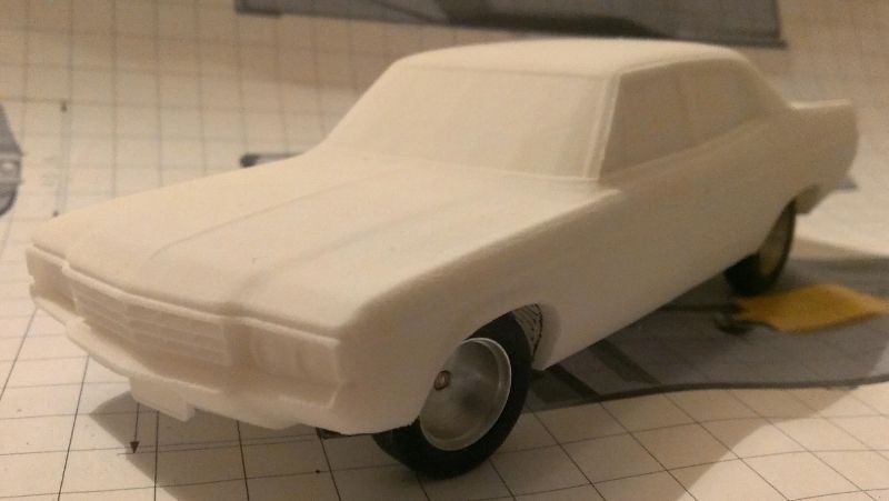

I uploaded the file, paid about 30% of what an SLA would cost and waited, nervously, for two weeks. Then this arrived!
It looked fantastic, the powdery surface was still there but it was much tighter than the SLS usually is, certainly much finer than my SLS chassis. I tried it out for size on a chassis, although I'd done all the checks on the computer before so I wasn't too worried about it fitting properly

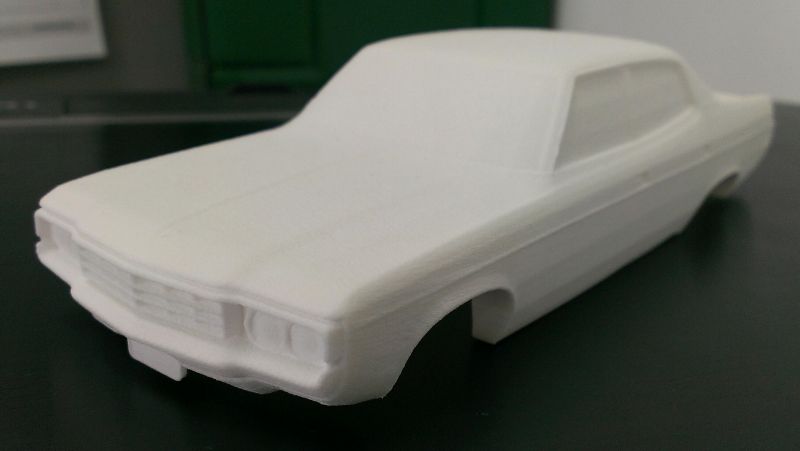

I then washed it, dried it and put some primer on. Then sanded it down and primered again.
It took about 5 coats, sanding down between each one, before I was satisfied that the surface was good. Then I got busy with the silicone mould as usual.

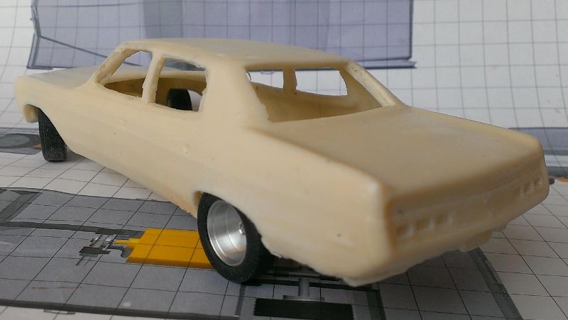

Today, the first resin casting came out of the mold and it looks great. The window apertures need a little more cleaning up but the surface quality is excellent.
It still needs windows, but I'm hoping one of my existing interiors will fit, and the wheel centres are similar to the later Dodge I already have. I see lots of this, in the car's future

The freshly printed body still looks rough to me, I understand you master it, sand, paint and fill it to make it all good, but is there a smoother material or higher resolution (more voxels?) method available for creating 3D printed objects (car bodies)?

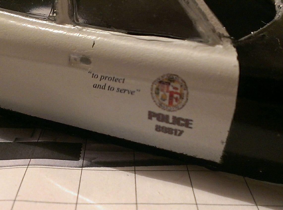

Postby choc-ice » Tue Apr 22, 2014 1:48 am

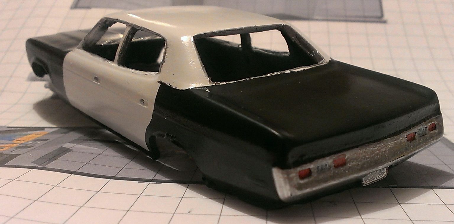

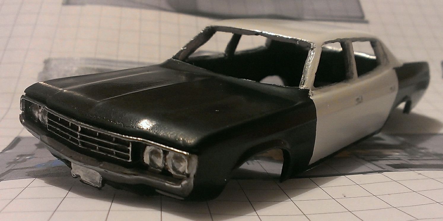

Finished at last!
The silicon mold came out well and the resin bodyshell looks neat, especially with some paint and chrome to pick out the details
I made up some graphics to mimic the Adam-12 cars which were pretty accurate to the LA police

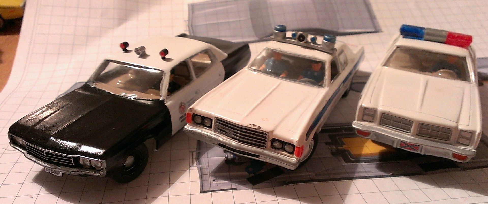

Then cast some roof lights and siren. I already have these for my Chicago police car, but of course they're different :roll:
Interior fitted and it's ready for the track
Call the cops!

Gareth - that has to be the coolest collection of 1:32 cop cars ever! Nice work on the Matador.
1-Adam-12, what's your 10?
