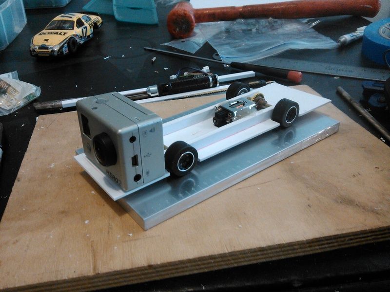

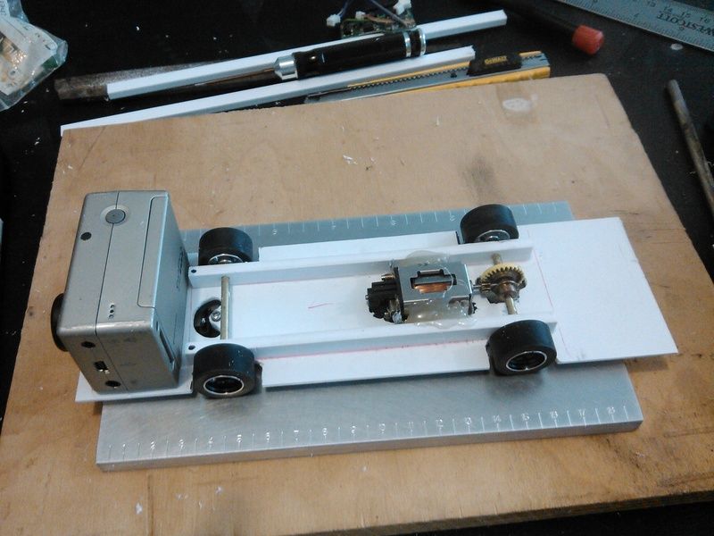

Postby buspor63 » Thu Mar 17, 2016 6:50 am
Finally had some time to devote to the project. Took the advice and went with the 2.0mm/ .080" sheet and added .187" X ..312" rectangular tubing because it looked about right. It's glued together with CA because I was in a rush. I had some brass tubing the right size for axle tubes, so that was used for axle carriers. The wheelbase is 4.25" and width 2.5"
The axles are Slot.it, wheels CB design 15X11 and Supertires 1108. Like most of us, it's stuff I had collecting dust. The motor is a SCX 42B with whatever gear was on there and a Slot.it 28 crown.
I'm at the point where I need to add wiring and the Carrera digital chip and try it out. The camera has some heft, so I'll need to run a counter weight. I'm also concerned about the overhangs touching some of the elevation changes, it's only styrene and I can build another if needed.

Postby Lou E » Thu Mar 17, 2016 8:44 am
Why not put the camera behind the front wheels?
