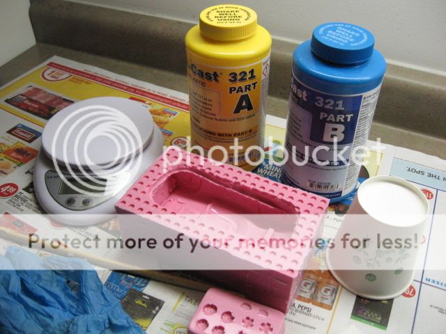

Materials:
resin - Smooth On Smooth-Cast 321 in off white color. Easier to see body features and imperfections than plain white.
kitchen scale - to measure weight of mixing batches of part A and part B. Purchased at Lee Valley
silicone gloves - to keep hands clean
small chop stick - to stir part A and B and to push out air bubbles and force resin in small crevices and crannies. The one piece ones that snap into a pair from fast food Asian take-outs
small paper or plastic mixing cup - for mixing resin
paper towel - eight small squares cut from one towel to clean up dripping material from containers and wiping excess resin
newsprint - to cover table top from inevitable spills

As mentioned, the resin does cure in about eight minutes, so I spill the resin in the mold to get coverage in the top of the body, moving it back and forth and then spend the rest of the time sloshing the resin along the sides, front and rear. All along I'm poking the resin into the voids and crevices with the chop stick.
You'll know when you've got to move really fast as the transparent mix quickly becomes opaque. If you think you've got too much in some spots just remove the excess with the chopstick, wiping it on to the paper towels.
As it comes to the end of solidifying, I turn the mold upside down for the excess to run down the sides, front and back and accumulating. I then remove any excess with the stick.
I try to leave it alone and within 20 minutes, it's already solid. I usually wait a couple of hours and pop it out, ready to do the next one.

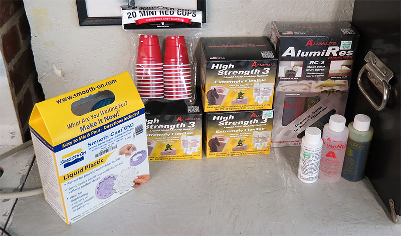

Another mold release some guys use is baby powder. They dust the mold and shake out excess. I haven't tried that, but am told it leaves a nice surface for paint adhesion and you have no problems with any left over mold release, which can really mess with your paint.
Harry showed the Alumilite 3 in his picture above. I can't say too much about how good this stuff is. It is so flexible that any undercuts are no problem at all. This stuff is so soft that it can easily stretch to allow your part from the mold. I have cast Cox Chaparral full figure drivers with the head glued on in this stuff. I eas able to cut a slit about 1 inch long and push the new part out of the mold.
