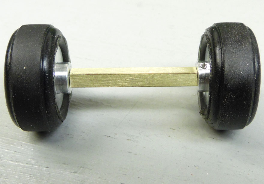

Hey, you are welcome. It is a great tire to hang on the wall as it fits 14 and 15 size wheels.
Anyway, here is a start on the front axle.
This should give you a good start point.
