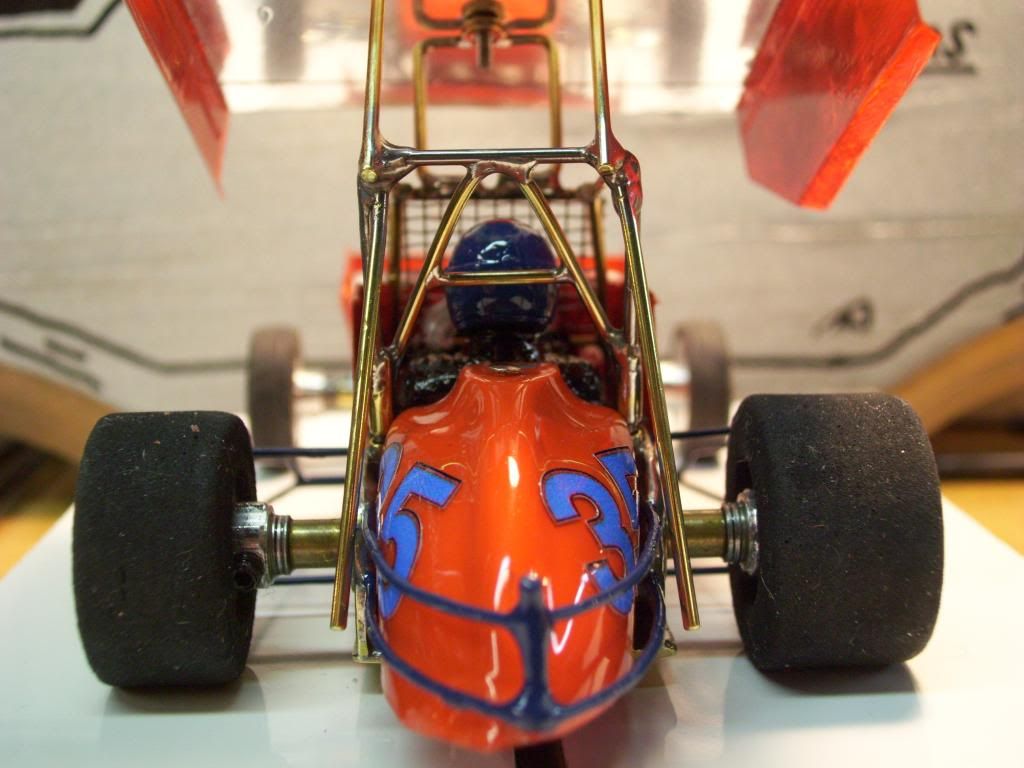

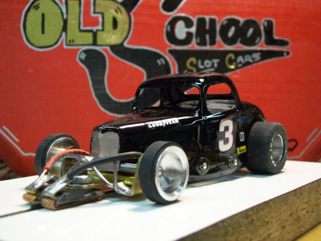

Postby Fleck » Tue Mar 05, 2013 11:32 am
HRW,

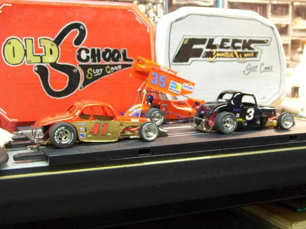

I was looking at some of the posts on soldering, lindberg-pyro kits and sprint cars builds.Listed
above is some of my junk and what I did with pyro kits. The sprint car along with the others are all
scratch built;brass, music wire, soldered with 60/40 solder using acid flux. The bodies are either
lexan or pteg; .020, .030 and the wings are made out .010 lexan.The chipmonks I race with have tor-
tured these cars and raced them hard. They hold up and handle fairly well. motor and gearing depends
on the track.

Postby HomeRacingWorld » Tue Mar 05, 2013 1:24 pm
Allright, great job sir!
You guys will appreciate the work you will see. Fleck is "old school" and has been doing this for longer than he wants to admit :)
He will tell you how good we have it today...compared to when they had to rummage through hobby store shelves looking little bits to use on slot cars.
That #3 car is bad to the bone.
Glad to see you have it working sir, I am just a phone call away if you need any more help.

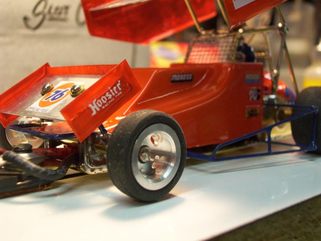

Postby Fleck » Tue Mar 05, 2013 9:01 pm
Hey guys,

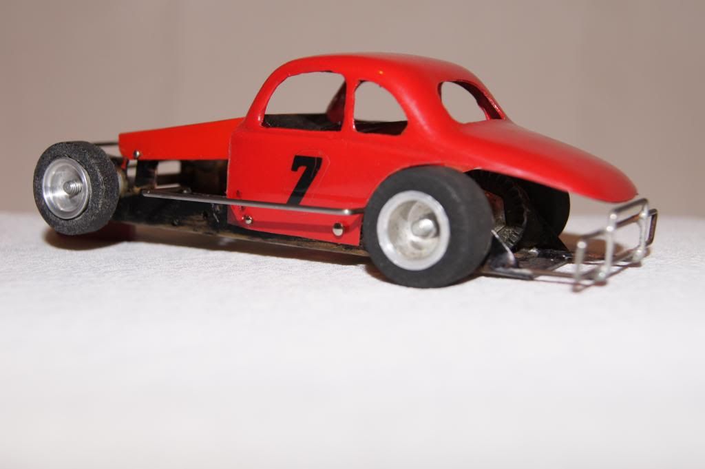

Thanks for the kind words. The wheels on the 35 sprinter are my wheels. I have backs to : 1/2" X1/2".
The pro tracks on the car were around when I built them. .875 dia. tire seems right for 1/32scale rears.
The fronts are 1/4" wide x.750 dia. I also make solid wheels for the 60's coupes and coaches. I use the
them on the reading heavies also. I will try and post some pictures of all the wheels .

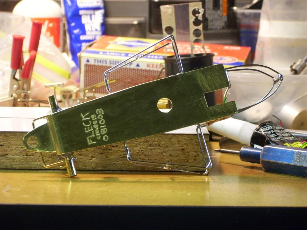

The sprint car frames are .031 brass plate, bars and cage are .047 brass and music wire. I will post some
pictures of sprint car frames.Llike I said in an earlier post I am in the process of redesigning my vacuum
former. It turned into a science project. I have all the molds done for the coupes and coaches. I have
molds for all the reading still cars in coupes and coaches. There are three different sprint car molds also.

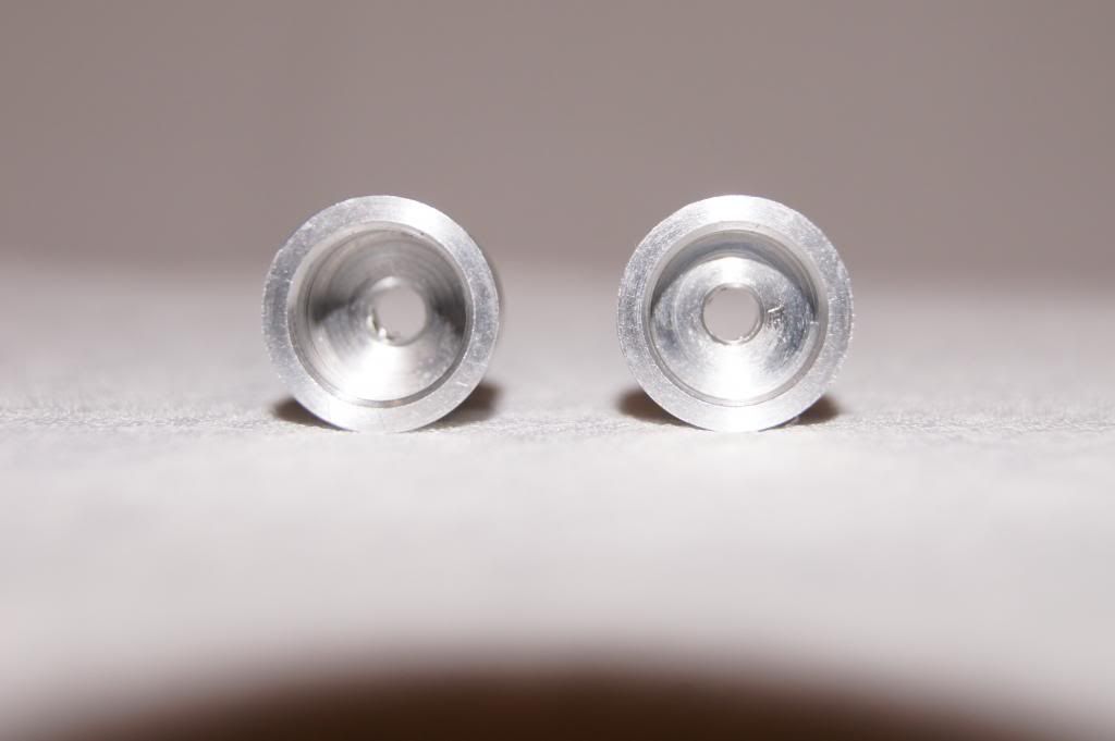

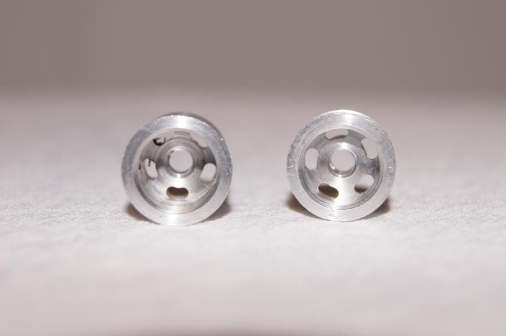

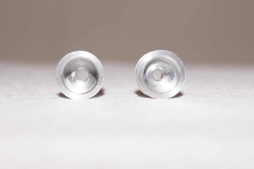

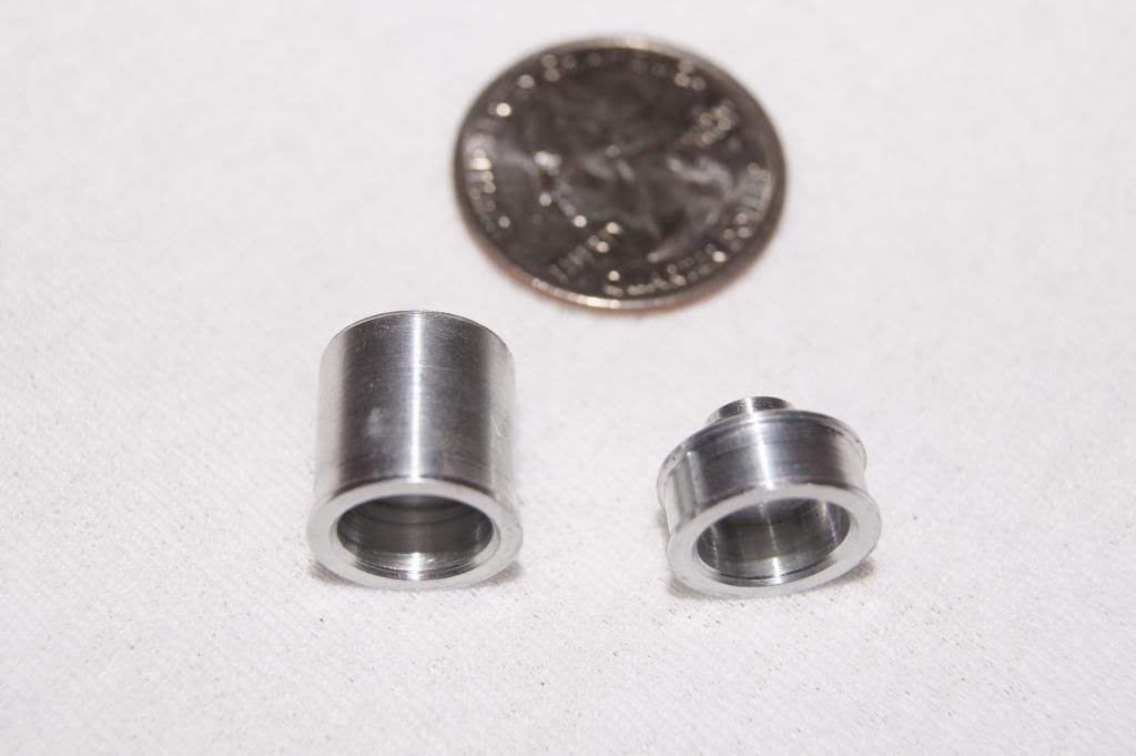

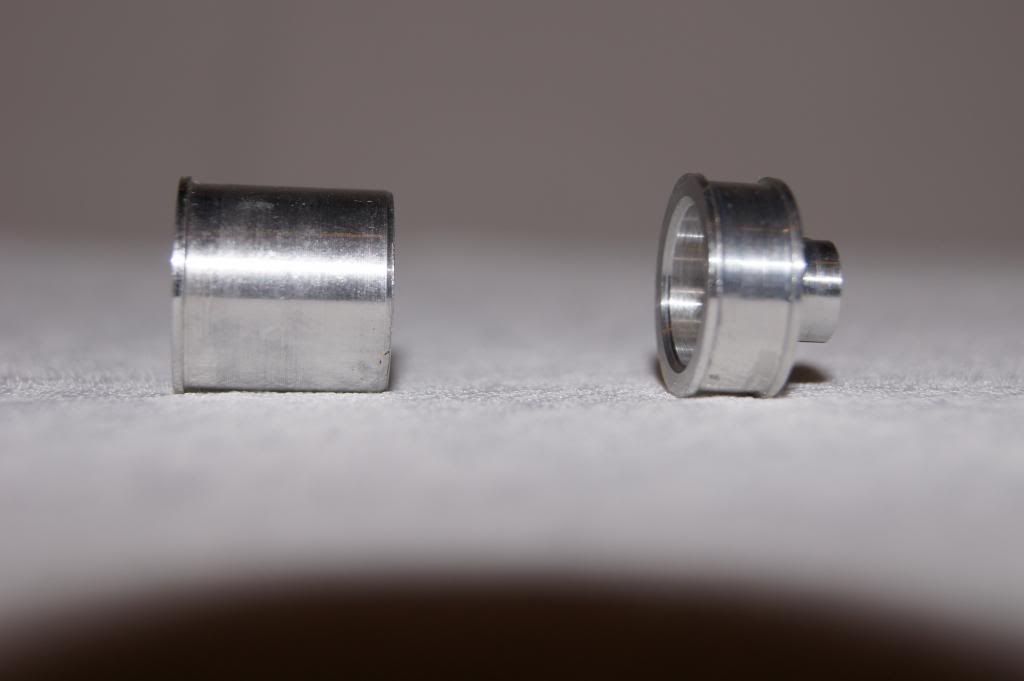

Postby Fleck » Thu Mar 07, 2013 12:03 pm
HRW,
Here some pictures of home scale mag wheels requested.
I'll send some pictures of sprint car frames in another post.
Thank-You,
FLECK

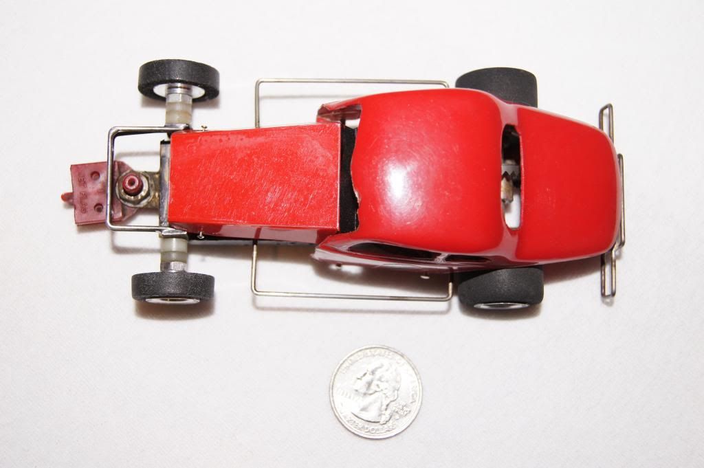

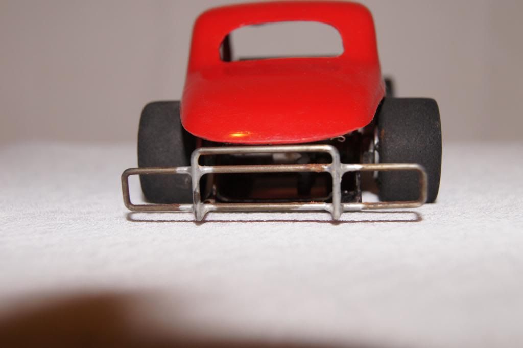

Postby Fleck » Thu Mar 07, 2013 12:14 pm
HRW,
Here Are pic's 1/32 Reading Heavies PROTO-TYPE.
Thank-You,
FLECK

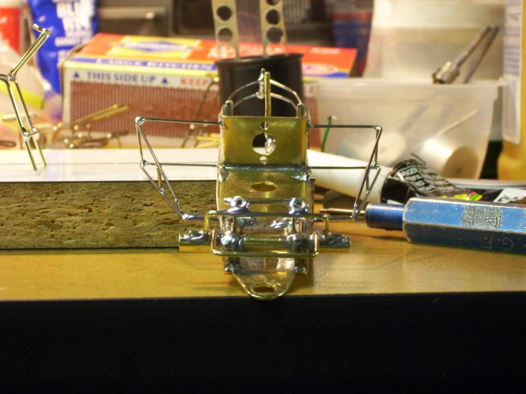

Postby Fleck » Thu Mar 07, 2013 2:06 pm
HRW,

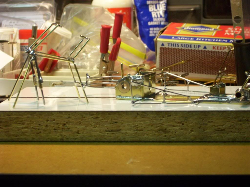

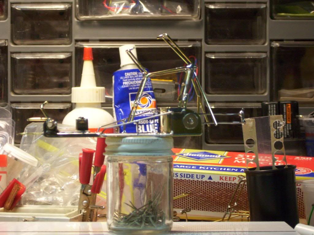

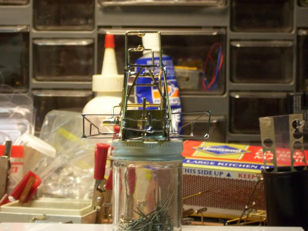

Here is the latest version of sprint car chassis with floating cage. Early versions did not have
this and it made aworld of difference in how they handle! I will post earlier versions at a later date.
Thank-You,
FLECK
