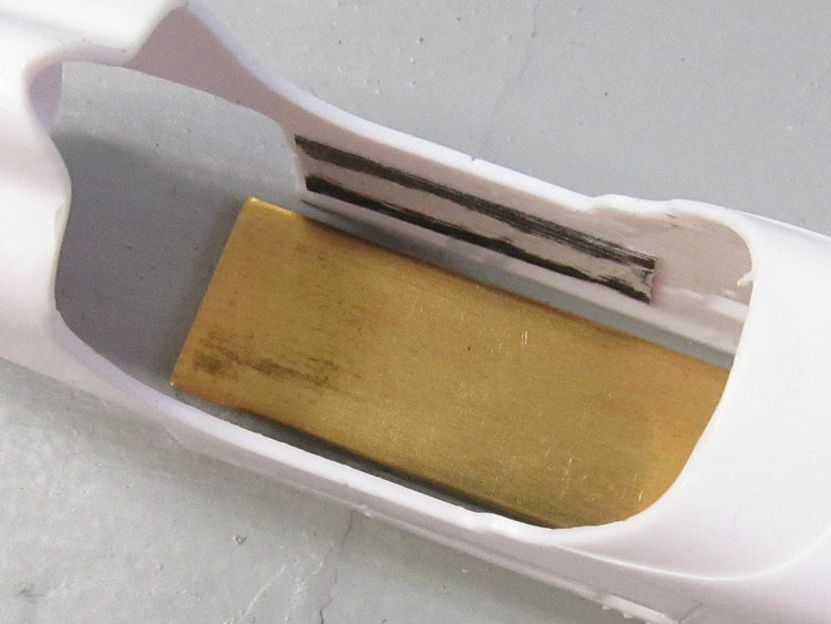

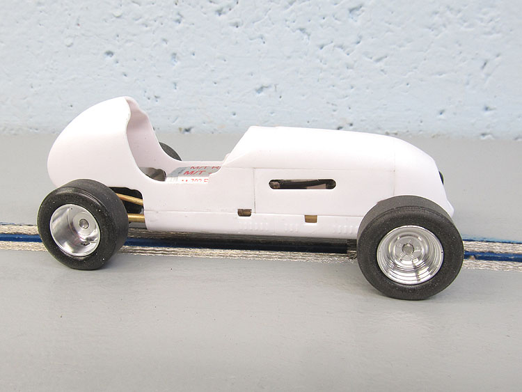

Well, got a little further this afternoon.
Hood and nose in place. Had to do some good wet sanding to clean up the fit, they had plenty of overlap. Not perfect, but clean enough I suppose.
Used my Dremel and cutting disc to get rid of the belly pan. then used 1/4 sanding barrel to clean it up and finally sandpaper by hand.
The strip fits fine. That is if I use it. Still in the chassis planning stages.

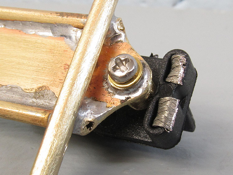

Postby HomeRacingWorld » Mon Feb 04, 2013 10:52 am

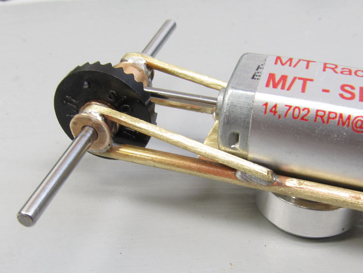

Not a design most use, just came up with something that would fit and work. So far so good.
Shaft is not perfectly lined with the axle, but VERY close and should be ok. Testing will tell the tale.

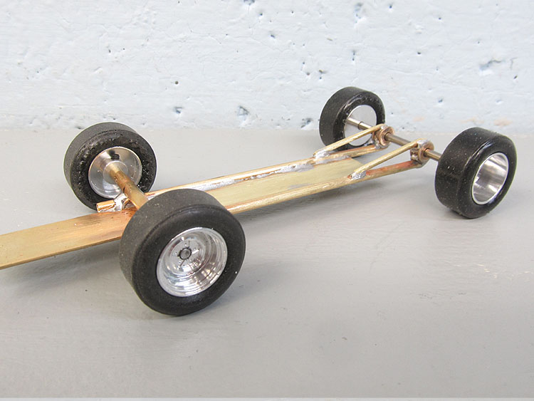

Postby HomeRacingWorld » Mon Feb 04, 2013 1:46 pm
Well, she is a roller :)
Set the width by what the kit had. Figured that is close enough :)

Re: Kurtis Midget Kit In
Postby DAVE » Mon Feb 04, 2013 2:19 pm
This might be too late for you, but the slimlines fit better turned 90 degrees so that the flats are
on the sides. You still will have enough ground clearance.
Postby HomeRacingWorld » Mon Feb 04, 2013 2:26 pm
Oh oh, somebody who knows what they are doing! :)
Too late, but it fits ok.
Thanks Dave, I appreciate your help here. You know I am going to booger this up sooner or later.

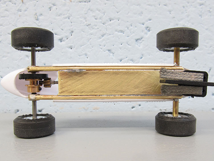

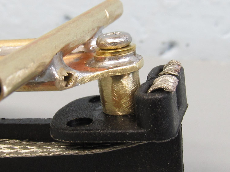

Postby HomeRacingWorld » Mon Feb 04, 2013 3:34 pm
Just went with a straight tube mount for the guide. I could have made a separate tongue at the right angles, just decided this was just as good.
Used 3/16" brass tube which sleeves it nice and snug.
Not the traditional route, but it will work. No slop to speak of and strong.
Postby HomeRacingWorld » Mon Feb 04, 2013 8:39 pm
Well, have a runner now. Motor is just glued in and just working out any issues.
9/27 Slot.it gears. Slot.it wood guide. SCC Wheels for testing, might go to 15x7....not sure yet.
Fun though! Still plenty to do, but she is trackin' now.
