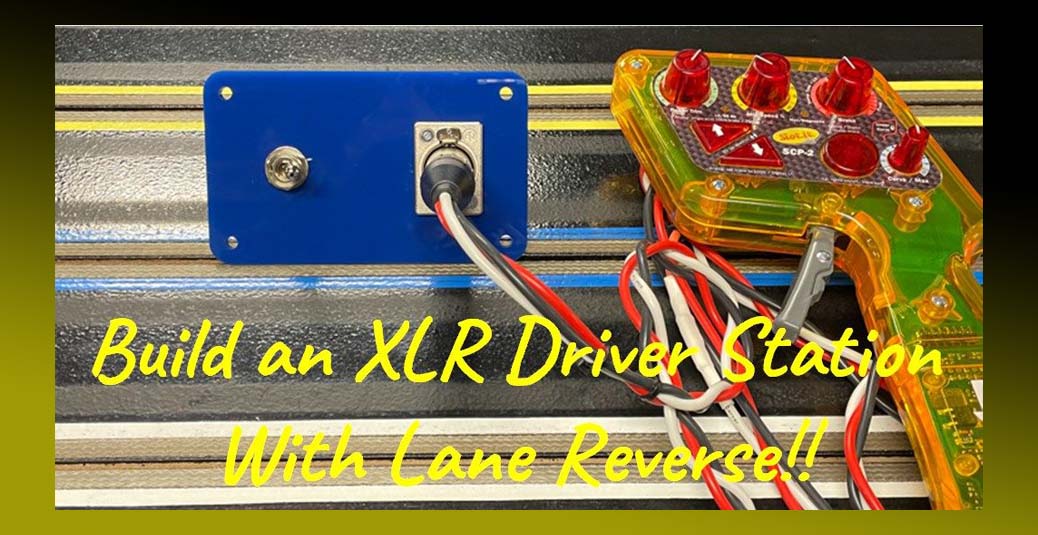

Build an XLR Driver Station With Lane Reverse Switch!!
XLR Driver Station With Direction Reversing Switch
Step-by-Step Assembly Instructions
Introduction
Since the inception of Slot Car Corner in 2006, we have offered a wide selection of slot car tracking wiring products and services including custom Driver Station fabrication services and high-quality, do-it-yourself Driver Station Kits. During this time, we have fabricated close to 1,000 driver stations for our customers worldwide. This article features our “XLR With Lane Reversing Switch” Driver Station Kit (SCC part number DS0220) shown below.
The driver station featured in this how-to article has a blue panel; however, kits with red, white, yellow, green, orange, purple and black are also available.  This driver station is designed for controllers with male inline XLR connectors and features a toggle switch that lets you run your track in both directions. Note this driver station, when wired as recommended, is polarity independent – it will work with both resistor and electronic controllers.
You can purchase this kit by following this link.
The step-by-step instructions, and accompanying photos, are designed to make assembling this driver station kit as straightforward and painless as possible. No electrical knowledge is required to assemble this kit and most tools required are probably already in your toolbox.  However, you will need a soldering iron (or soldering station) to solder three (3) wires to the XLR jack.  Assembly typically takes about 60-90 minutes for the first kit and 45-60 minutes for each subsequent kit. We STRONGLY recommend reading through this entire document to become familiar with the steps BEFORE starting to assemble the kit. Additional resources including installation instructions, wiring diagrams, etc. are available on our website. Please refer to the “Additional Resources” section at the end of this article. As always, we are here to help – the “Contact” page on our website provides information about contacting us should you need further assistance.
