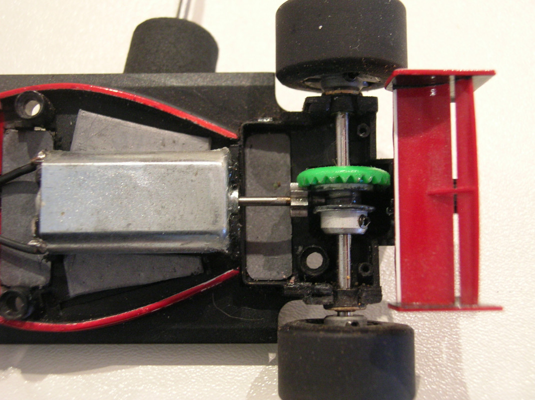

Below are pics of two older Scaley cars done with braces many moons ago...........
The first is an older McLaren (2005)......it allowed me to bend a "U" shape of .032 brass strip and glue it along the motor mount face, and under the bushings.
****Depending on the height of the strip you use, you may need to grind a relief in it in order to clear the motor bushing motor shaft.....I had to do this on this car.
The next car is one of Kimi's 2007 Ferraris......a different design chassis plate made me use some thinner brass.
This pic. is not great, but the brass is glued to the motor mount face, and the "legs" run under the bushings...all the way back.
I have used piano wire bent into a "U" (.047/.055 is more than enough), sheet aluminum, and styrene (strip and square).......all work equally well, but, unfortunately don't have any handy example pics.

Hi Mark, We were focusing on beefing up the rear axle bushing mount area; what Chris showed did that very nicely. When you start running stiffening bars the length of the chassis, or most of it, then you may be strengthening the rear axle bushing supports in the process, but you're doing more than that in the process. So, I would have to say no to the overall chassis stiffening layout that you have shown; sorry. A U-shaped piano wire support; one ending where you have yours now and turning just in front of the rear motor mount; similar to what Chris showed, would be fine. So, yes to piano wire, but not for the strengthening of the chassis plate; just for the area around the rear axle bushing holders.
