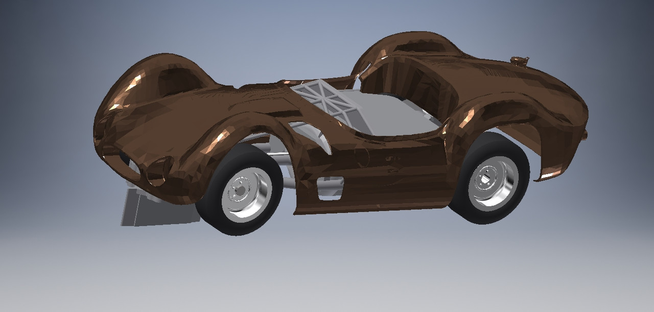

Postby ccobra » Mon Feb 18, 2019 10:09 am
Do you have a birdcage yet? If you want one I can send you the file. I had to make the tubing larger than the scaled 12-18mm tubing size since when printing on an angle the 0.035 diameter is too small to completely print, even though it looks good on the screen.
It's an inline chassis that uses slot-it parts like the flag, and gears. The motor is a Tuna 16k but any H&R or Piranha will work also. And the front axles are 3/32 rivets. The motor goes up from below and is attached with two 2mm screws and the rear axle uses the 3/32 x 3/16 bushings.
Just needs seats, steering wheel, and a driver added to complete the interior.

Postby dreinecke » Mon Feb 18, 2019 11:03 am
Wow!!! That looks great. I am worried about a full can fitting under it
Can I please have you email me that?
