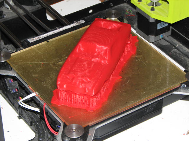

Scanning can be a real challenge but nothing to be discouraged by. I opted out for the reasonably priced Matter and Form unit and currently running the third version of the software. With each revision of the software, the scan process changes and makes it somewhat easier. Recently I downloaded the third version of software so I thought it was time to give it a try so I purchased a 1/25 scale model of a 73 Mustang Mach 1. It wasn't a 72 but I figured that I could add a little putty and change that. Anyway I started the scan which took over an hour per scan and finished the three scans. Then I ran it through Nettfab, scaling it down to 1/32 and giving it a 1.5mm shell.
After about five hours the print didn't look to impressive.

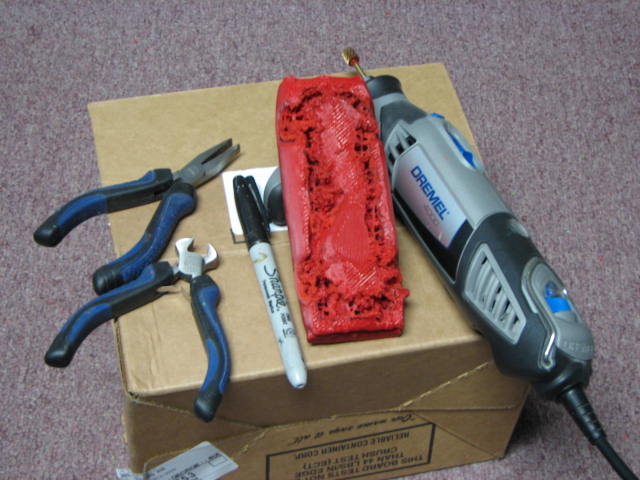

But I figured what the heck, so I got out the tools and started working on it.
First I mark the cuts, then dremel around the cuts, and finally remove the material.
After much sanding and adding some milliput it did show some promise so I printed up a chassis and a running mate for a build to start my own Ford Chevy wars.
