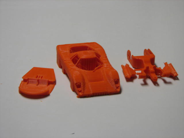

I used the standard settings for ABS with the exception of cranking up the temp to 250c and laying down the layers at 0.20mm with a 0.30mm base, and a final temp of 245, and 30% infill. There may be a little string action going on but I can live with that better than the
Now its time to add a coat of the XTC-3D so that I can start cleaning out the support material. I started doing that to preserve the print a little more, especially with this one with the wiper detail and the windshield posts being so thin. After cleaning the plan is to throw some mud inside to make a mold of for the windows thus trying out my new vacuum mold machine.
