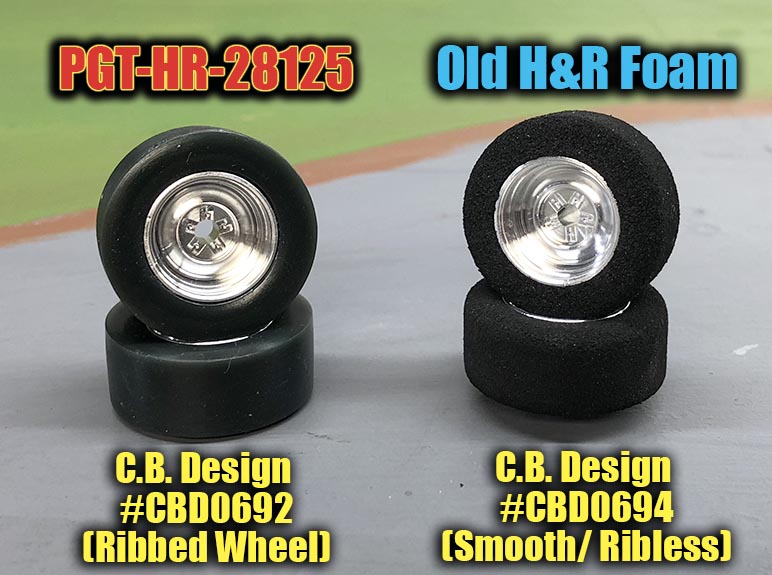

Have had this nice Mustang built for me few years back one of the greatest slot car builders in our hobby. I chose it as it fit the proxy and just needed some updating.
I will be changing to the SCC Steely wheels for this car. They used those too, and it looks great on this old horse.

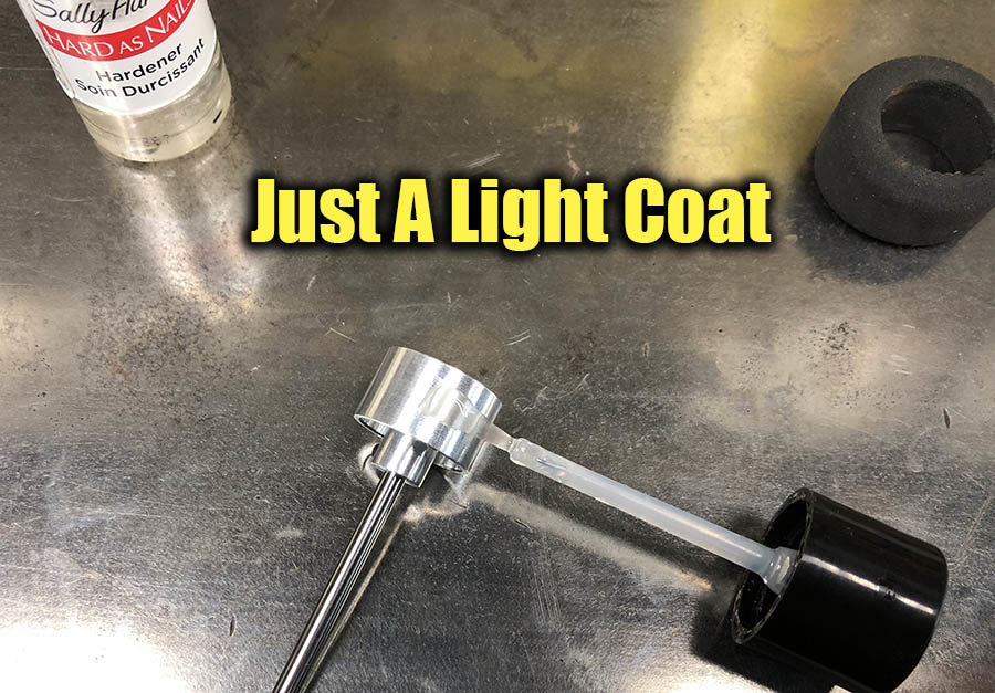

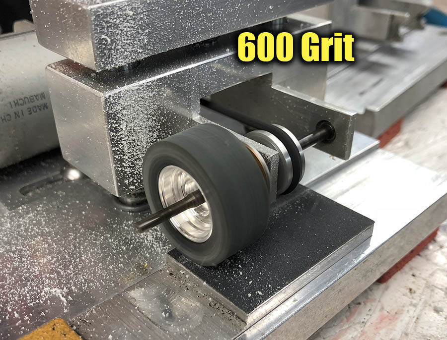

I already posted the videos, but real quick is just a simple glue on procedure. Hansens hard as nails for both the old foams and rear urethanes.

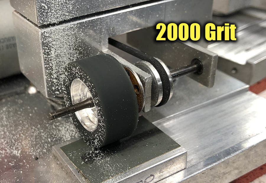

Once dry it's off to the Tire Razor for a quick true.
For the foams and the start of the PG tires, I used 600 grit.
I finished the PG tires with 2000 grit.

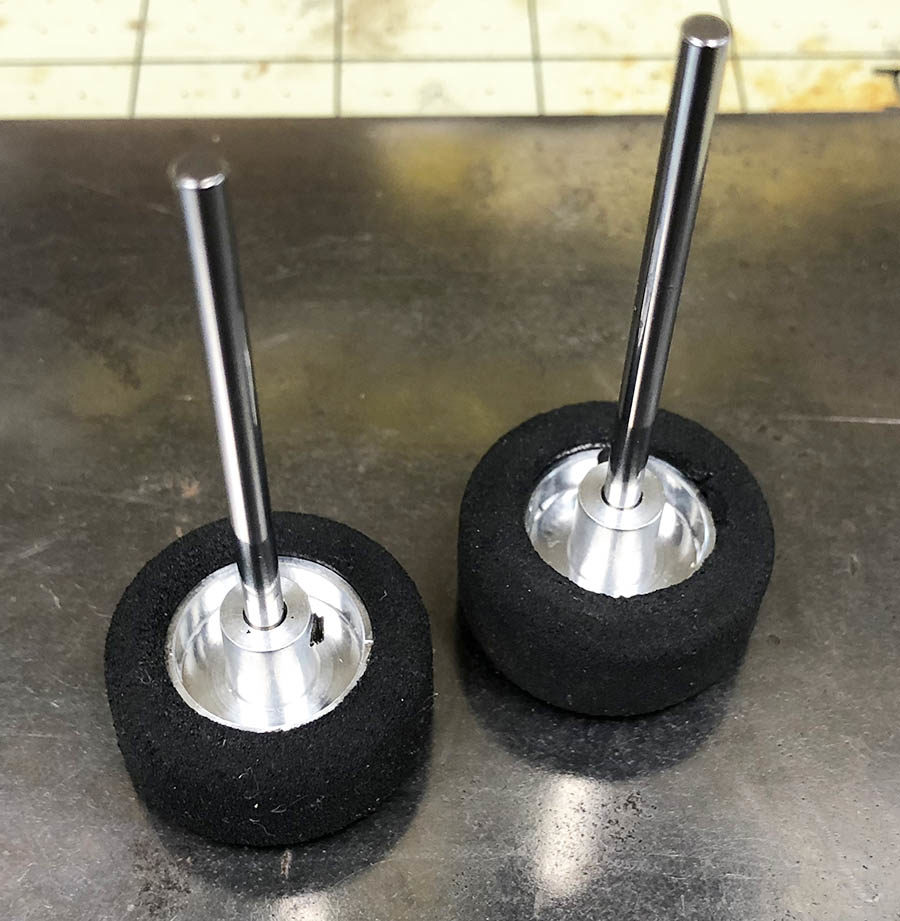

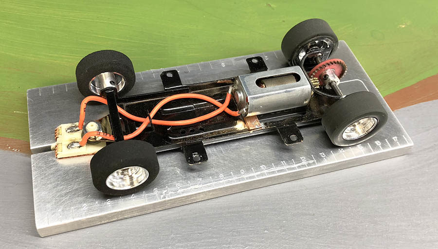

So here is my setup. Old foams in front on CB Steelys, and fresh PG on the rear.
More to come as I fire up the Ye Olde Forge and beat this chassis into a semi-straight shape! (We raced them hard around here!)

Hey : My Tire Razor doesn't look like that .
Austin
Posts: 1253
Location: Merrimack, NH
Re: Pony Entry! WIP
Postby HomeRacingWorld » Tue Sep 11, 2018 5:16 am
This is the “Pro” version. It’s a single fixed axle system with the axle being a 3/32 - 1/8 combination. 3/32 on the far end and enlarges to 1/8. Designed for all the CB Design/aluminum set screw wheels we use.

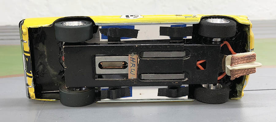

Again, not the way everyone approaches body mounting. Just easy for me.
If you place the body over the chassis and shim it, you KNOW EXACTLY the stance and height. Plus, when you drop your pans in, they match up with your chassis tabs perfectly. So when it comes time to loosen things up for float, there is no binding.
Anyway, thanks and hope it helps a few.

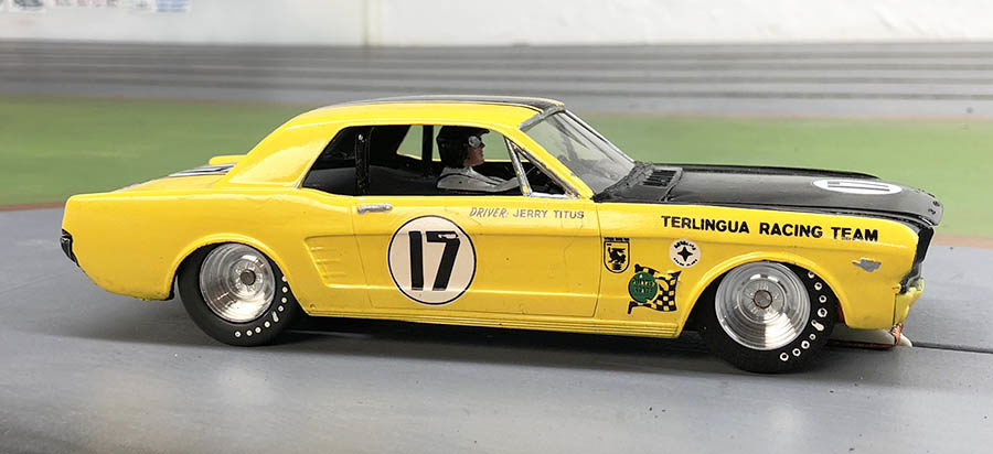

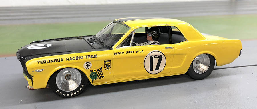

Well it's finished. This old warrior won't win any concours thanks to hard racing over this many years, but it's in the race and that was the goal.
First a Kudo to the UV adhesive. I tell ya boys, there isn't a better adhesive for glass/interior trays, etc.

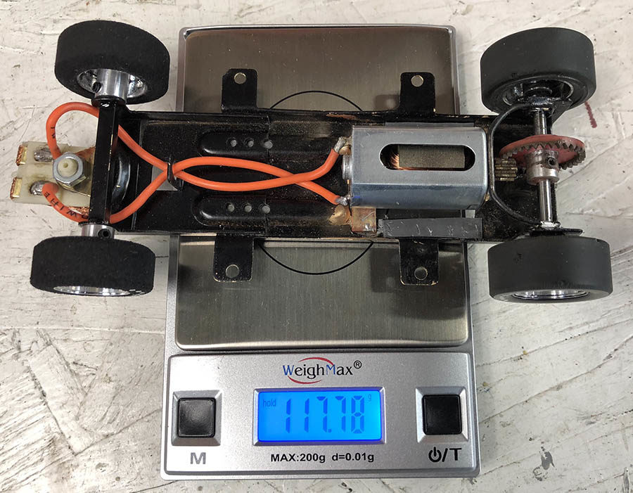

Mods to the chassis: Had to make a new brace for the JAWS motors and align the rear and front axle. My own doing as the motor swap caused the work.
Only the unused front axle placements and excess side pan material removed. None of which makes it any better than a stock.

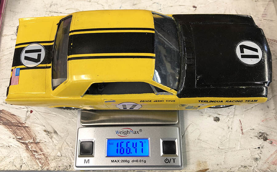

It's not that light. I added lead strips as you can see in other photos. Until you have raced these in anger, you cannot appreciate the added weight where it counts.
So it is off to Georgia to be a Peach or a Pit. I'm leaning toward pittage.
