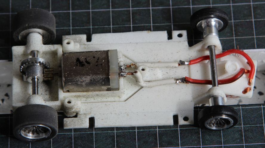

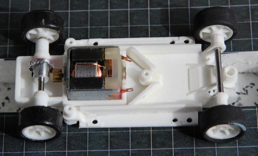

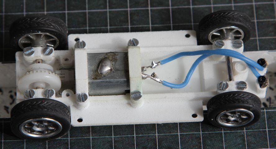

adapting one of the printed chassis will be no problem, Mas!
will need some measurements, so.
Did you get pictures? Maybe i have that car and can measure it by myself?
1) Boxer motor chassis? motorpod?
2) chassis using carrera/scx parts
3) FF030 chassis with motorpod?

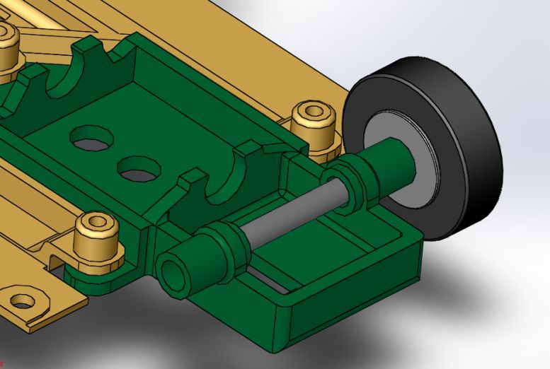

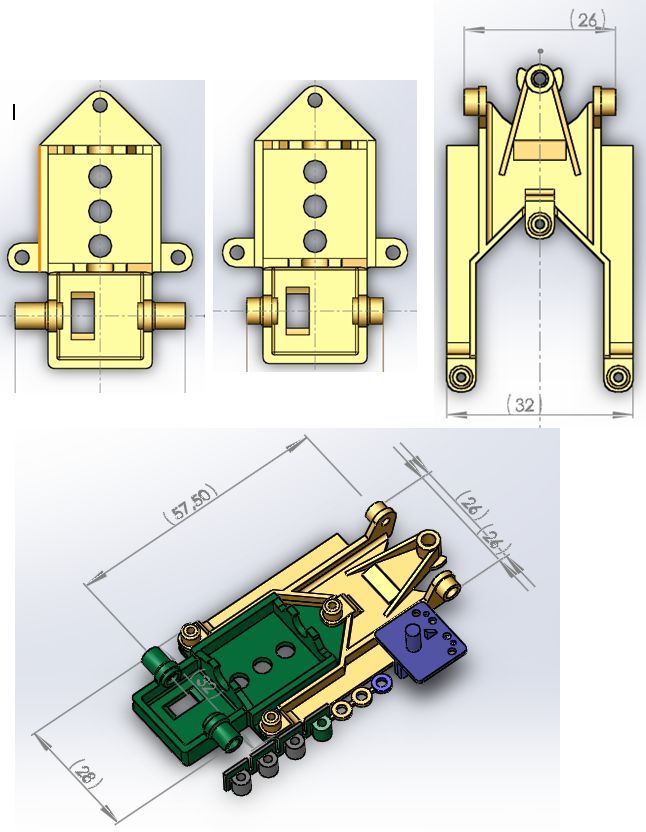

i´m using the front and rear axle tubes for centering of the axles.
Especially on the rear, this helps for centering the crown gear and will help the wear of the crown a little, plus it can be easier adjusted.
The Boxer-Pod chassis has a minimum width of 32mm, so your 33mm are no problem :)
below is a pic of what you will get ;)

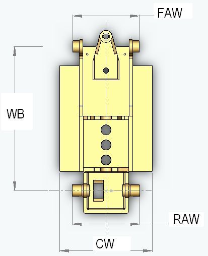

just let me know the measurements and i can adjust the chassis!
I have to do the adjustments on my laptop and upload the changed files to shapeways, with a name that you can recognizw as your project.
The chassis will accept 0.085" axles and 0.093" axles. I also use the smaller 0,085" axles. Beware: you will have to drill out the axles holes with a drill bit!
i have also used brass tube with 0,093" inner diameter as a metall bearing. Fits not too bad for the smaller axles, but really nice for the bigger ones (like Kyosho).
trimming the axle tubes works good, but i prefer to do the measuring in front, in this way i don´t have to take care of it later. i tend to take away only very small amounts and measure a lot. Been taking away too much too often and now i tend to do very small cuts. But it takes time in this way, but at least it will work out in the end.
