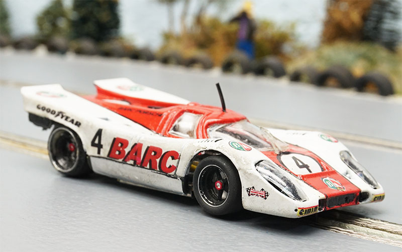

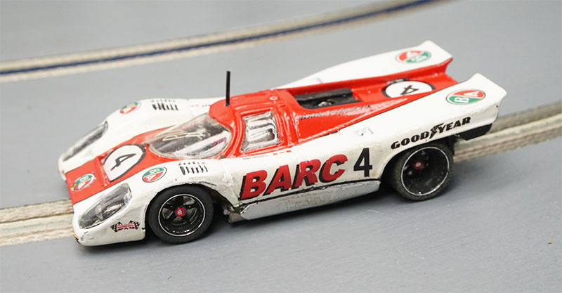

Had a nice surprise arrive in BARC's Brass-Am entry. He included his 917 that he custom built and asked me to give it a run.

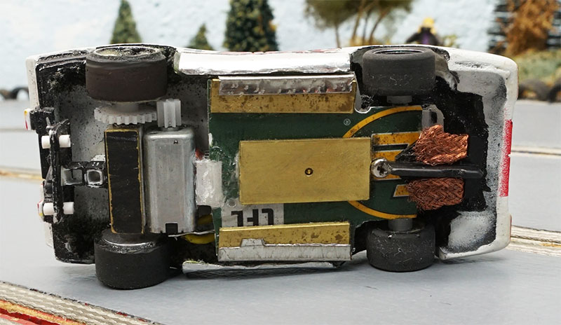

This chassis is interesting with the material combinations he used.

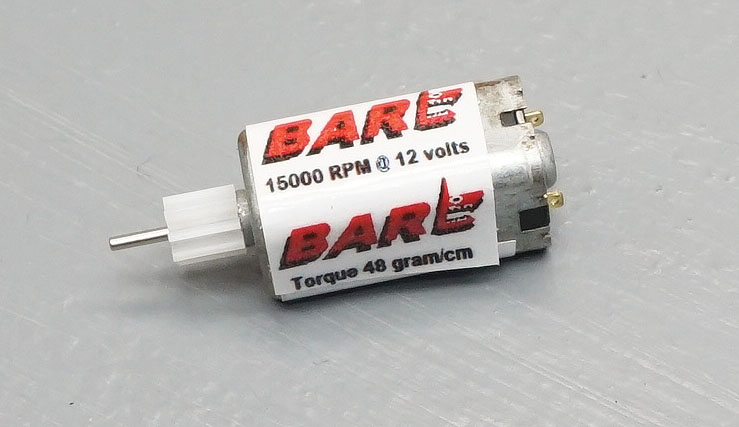

The little motor is also an interesting outfit. It's a tiny little rascal but it works very well on my track.
This car ran great. Very smooth and much easier to drive than I expected. Good balance of weight and power IMHO.
Thanks for sending this in! I am supposed to run the Brass-Am but I'm not sure :) Having a ball with this little car.

Nice work all around! That's a scratch build!

That is the Gift card chassis, but I am modifying it to be completely brass now that I have had couple of brass chassis under my belt.

You will receive 3 similariy prepared cars, but the 917 was bumped out of contention during testing so will not be making the journey to the Desmo. The 917 is a little heavy and kind of a tail wagger. Fun to drive though, but gives up some lap time to the other cars I prepared
All the entries have this motor though

personally i think that too much weight is not really necessary, but this is only applicable for my track and i really know this. Each track offers its own combination of grip/smoothness/bumpiness and maybe more. driver capabilities of course, too.
Additional weight, if not needed to lower the CoG, will only push the car out in the corners and slow acceleration and lengthen braking. therefore maybe, the 917 is carrying a little too much brass on its belly to get fastest lap, as you already experienced on your track reading your words.

You are correct that this car is a little on the heavy side, and most likely why it was outpaced by the other cars I am sending. However it has a low COG, and because of this it spins flat and is very predictable. You are in complete control with no surprises. You find the limit and then just drive it there. I'll send it along as a non competitor.
