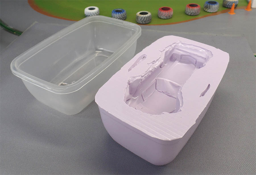

Many casters make their own boxes from various materials. Others use the handy slot car case lids.
But I just don't have many case lids and found some inexpensive food containers. I tested the size and they seem to fit just right.
They are 4x7 and come with a lid. Not much need for the lid but the tub works great.

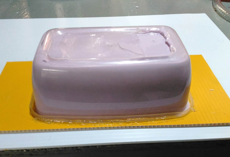

Just cut a pouring hole up front and then hot glued the tub to my base and poured away.
You can push the mold out from the pour hole.
I am finding these at Dollar Tree, Family Dollar and even our own local grocer. You get 2 tubs for $1.00
Just an option.

Pretty slick & definitely inexpensive!
(and have the added bonus of being conveniently stackable when not in use!

Quick not about the mold Harry showed above. This mold has quite a bit of thickness on the sides. I kind of got caught up trying to not use more materials than necessary a few years ago and started making my boxes just slightly larger than the master so I could save material. I found out that it is best to never scrimp on materials. Make your box a fairly large size and it will be solid and not easily torn. If you ma

Quick not about the mold Harry showed above. This mold has quite a bit of thickness on the sides. I kind of got caught up trying to not use more materials than necessary a few years ago and started making my boxes just slightly larger than the master so I could save material. I found out that it is best to never scrimp on materials. Make your box a fairly large size and the mold will be solid and not easily torn. If you make an inner plug, it will not push out the mold sides and make a thicker body than you want. The lesson is not scrimp on materials. Same with your plastic. Better to have excess and puor a driver or some other extra part than to try and mix just enough plastic for your mold, end up a little short and throw away a 90% completed body.

Indeed. This is why I have no issues with the thickness all around.
The mold I have now is very strong and should last a long time. I'm not in commercial production, but I want to be able to make these for people who really want them in the future.

Most casters advise at least 1/2 inch. The sides on mine (at the door) are about 5/8. Pretty stout.
After a few molds, my material usage is about 2 1/2 to 3 pounds of silicone per car. That is making the inner mold (plug).

And here is boxes made using sign board and hot glue. HOT GLUE IS YOUR FRIEND.
