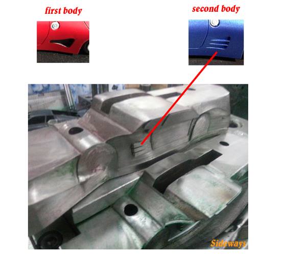

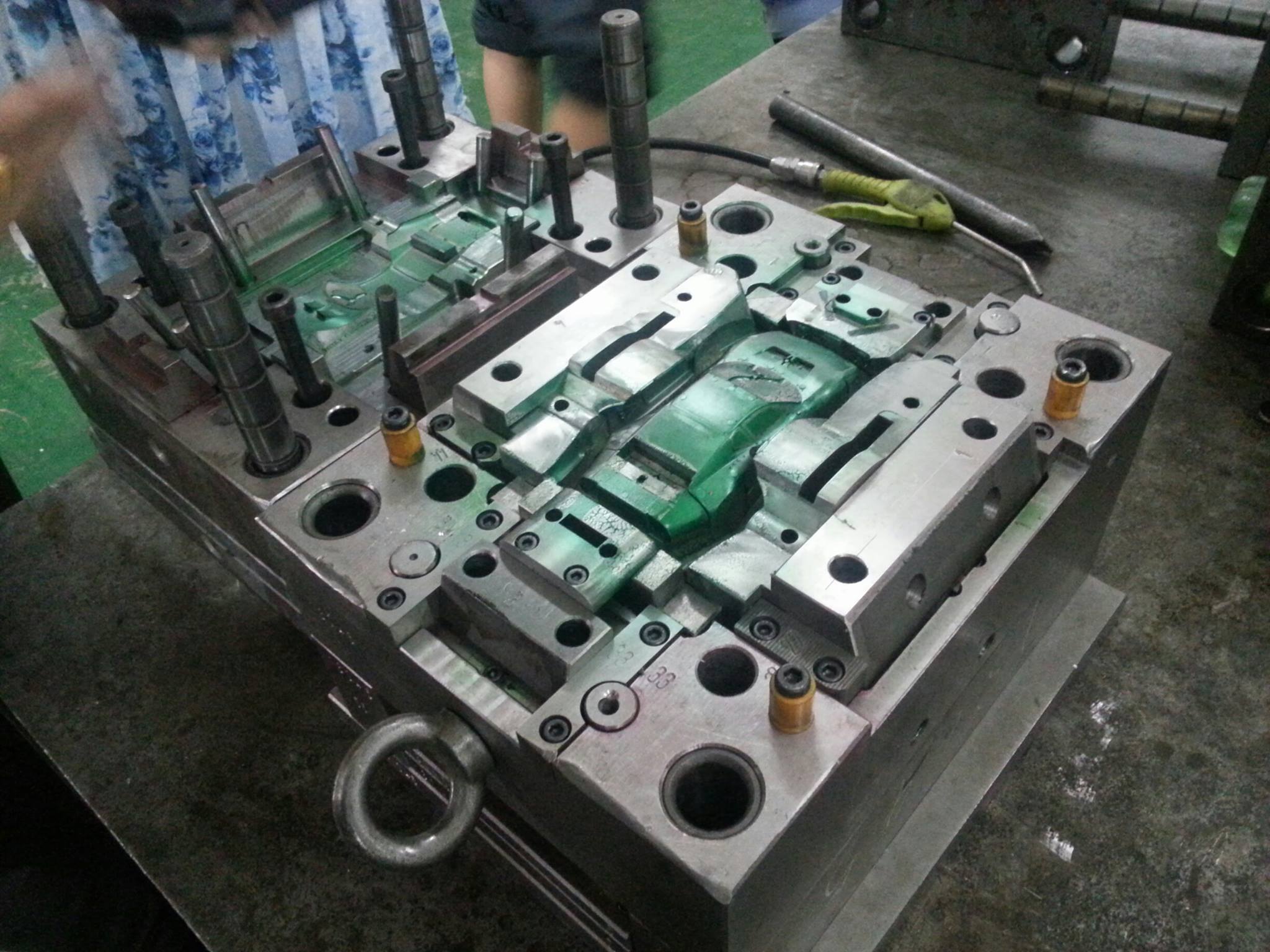

Seen these and thought some of you would be interested.

The 2 sides and both ends slide shut when the press closes, then they open up so the body can be ejected, just think of the fit that it all has to be to not flash we are talking .0005 and less, a hair is .003 :o
Re: Racer mold/tooling shots
Postby DAVE » Wed Sep 04, 2013 3:39 pm
Looks like it is for the Ferrari BBLM. That tool is for the main body casting. There are lots more
injection molds needed to produce the complete body. And there are other types of tooling
involved in making the many parts that go into a slot car. Not as easy to do as some might think.

The cost is amortized across thousands of shots, so incrementally it's not much (but it is still in there). Yes, the same things were done 60 years ago but they were done by skilled craftsmen....now a CNC and EDM will turn out the mold with far fewer man-hours involved. Very frankly, one of the big problems in this day and age is the loss of knowledge about how to do those things.......but I digress ;)
Also, don't forget that for every body that makes it to the shelves there are several that end up in the scrap/regrind bin for warpage or being somehow out of tolerance......but those shots are still part of the amortization. And often times molds are made to run several different parts at once, with the ability to block off different cavities so that one tool can be used for multiple parts which saves money.
But yes, overall it's still kind of amazing that the body costs as little as it does :D

I also wonder how it can be profitable to make the cars. The volume has to be on the low side and the parts and work required are considerable. When you factor in painting and assembling, and then look at what the cars sell to the distributers for it hardly seems possible.
Thanks for the pic of the mold, I have been wondering how the side bits were made. I do plastic injection as a part time hobby but my abilities are very low compared to this. Someday I would like to advance to this level. I was looking at the Palmer Plastics kits and even those are beyond me at this point. Those kits were flat and you had to glue the side of the car to the top, then glue the front and back in. This slide mold sort of does it all in one piece.
It is not clear in the pic where the injection point is. On the cars I have it is impossible to find the injection point, it must cut off so cleanly.
