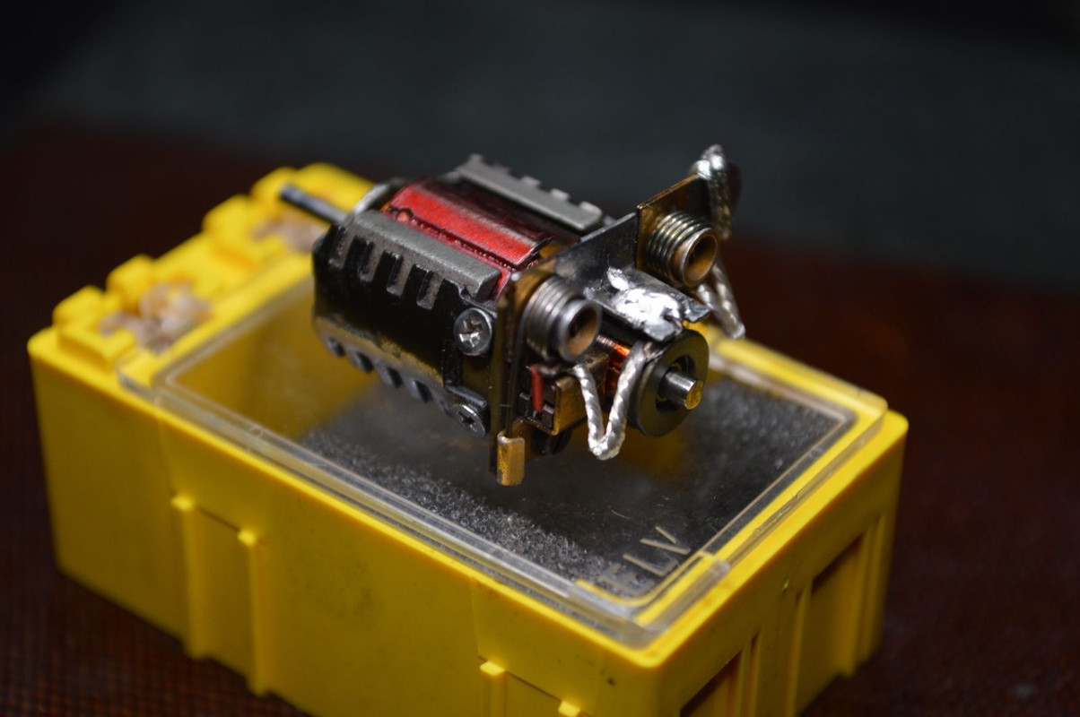

A few early train/slot open frame motors (mainly Tyco)..........long buggers, but still a lot used in Vintage race meetings
An "open" GP27 motor (still 3 pole).......two thirds the size of a Slot-it 21/25K FC130 motor........unbelievable power (and cost),.....and you will need in excess of 10 amps to make it tick over.
