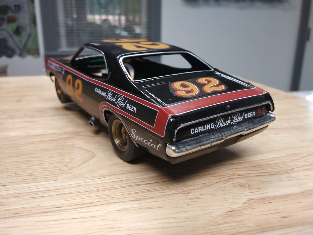

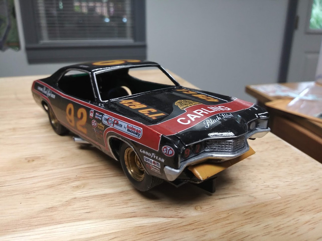

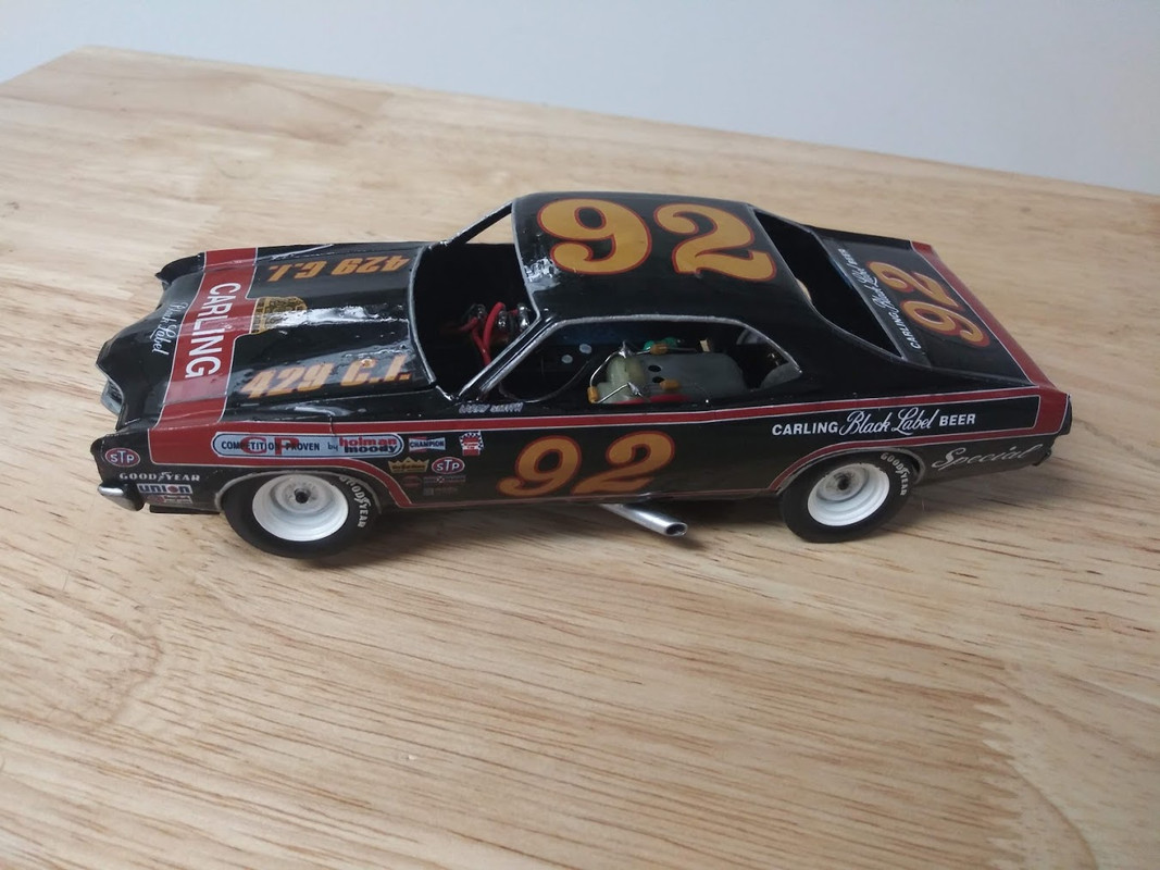

One of the least requested decal sets has been the 92. At first I thought it was going to be hard to make and the first car ended in wrinkles. If someone decides to have a go at the 92 here are some issues I had and how they were fixed.
The driver name pushes the stripe down too low and the door handle wrinkles things up. This car was ruined by the clear coat cracking all over so it is now in the tub to be stripped.
I started a new one with a couple new ideas.
The door handles were filed off and the rear panel was also filed flat after gluing in the tail lights.
I sprayed with black and then applied decals. The driver name was relocated to the roof. The word "special" and the sponsors in front of the front tire were cut off the side decal. The STP on the front logo bunch was also cut off to allow for better application.
The front spoiler was painted to match the numbers. The grill was sprayed silver and rubbed with antiquing to create some shadowing.
The rear is now another place for the sponsor to be placed.
When applying the decals I cut them out and used a black sharpie to run around the edge to better hide the white under color that is often visible at the edges when it is cut.
Now to clear coat and hope it does not again get ruined. I use floor polish but it sometimes cracks all to pieces on me. I think it happens if the underlying paint is not completely dry.
Here it is cleared and ready to race. Not too bad. I normally avoid black slot cars but this just adds to my urge to paint the track finally.
