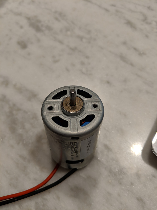

This might become obvious real soon, but I know nothing about electric motors, and need the sharp folks here at HRW to help me with some advice.
I want to upgrade the motor on my tyre (also "tire" :D ) truer, preferable with one that delivers a bit more torque, especially at lower (6v) voltage. Could brushless be an option and will it be worth the extra $? The motor resembles those that can be found in RC cars....I have always been a gas RC guy, know nothing about the world of electrics!
The diameter of the motor and shaft needs to be the same, but the motor can be longer than the one in the pictures below.
Motor Dia: 35.6mm (cannot be larger)
Shaft Dia: 3.2mm (must be the same)
Front Bearing housing Dia: 13mm (cannot be bigger)
Motor Length: 50mm (can be longer)
Screw mounting: 25mm on centre

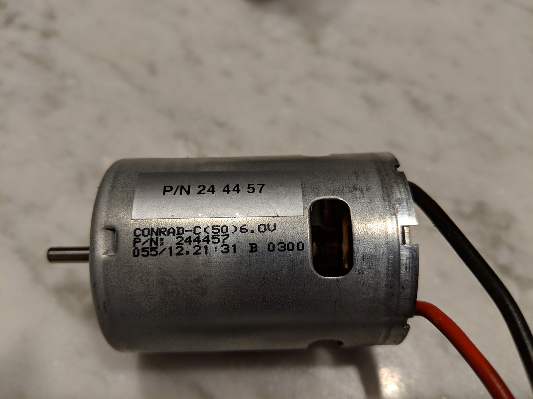

Below are pictures of the current motor and the printing on the side - maybe this makes sense to someone.
Thanks for your help (please post a link if you can to the source)

That motor is called a 540 can - very common way back in the day in RC. They still use them today - but most people are using brushless and that motor (the older style) has traditional carbon brushes... Like a slot car.
If you google 540 brushed motor you will get hundreds of options.
They rate aftermarket RC motors by # of turns and how many wires are on the armature. The lower the turns, the faster the motor will go but with less torque. Higher turns not as fast but tons of torque. The rock crawler RC cars use 27T singles because they need to torque.... The more wires -the higher the torque at more voltage. A single wire generates more punch from a standing start but the curve drops out where the torque on a triple (three wires) may kick in at 4 volts.
The 20 turn single above is probably way more than enough over the motor that comes with the unit. Keep in mind that RPM is probably about 18k-20k at 7V.....
I wouldn't get the open endbell version with removable brushes - there's too much stuff flying around that will get into the motor.

Thanks for the great info, I have learned a lot and was able to do get additional info by Googling with the details you provided.
It appears that either the 540 or 550 would work, they have the same can size, the 550 is longer.
As Matt mentioned there are many, maybe too many to choose from. Pricing is very reasonable, many costing less than a slot car motor!
I think I am going to try a 35T motor that is used for RC crawling - I also have 27T and 55T options. The crawling motors seems to make sense, since they are designed to have high torque at low rpm.
Further to the comment from Rich - I am experienced at truing tyres (does not mean I am an expert!) and have a few tyre truers to choose from. I use the Area 3 (now Prof. Motor) and a Hudy. Recently I got a beautiful RSM 3.1 (https://www.overdrive-shop.com/Tire-truer-RSM31) from Germany. Truing tyres, albeit as boring as watching paint dry, is super important for proxy (or any) racing on wood, no magnet! It is the RSM motor that I want to upgrade.
Here are the specification on the motor from the RSM (my pictures in post #1) https://www.conrad.com/p/universal-brus ... rpm-244457
Here is an example of a possible upgrade - would this be an improvement, will it work??
