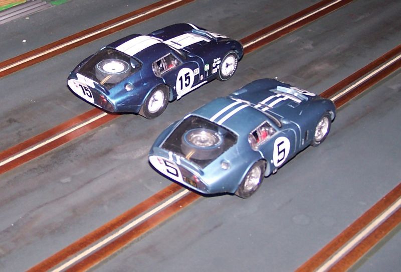

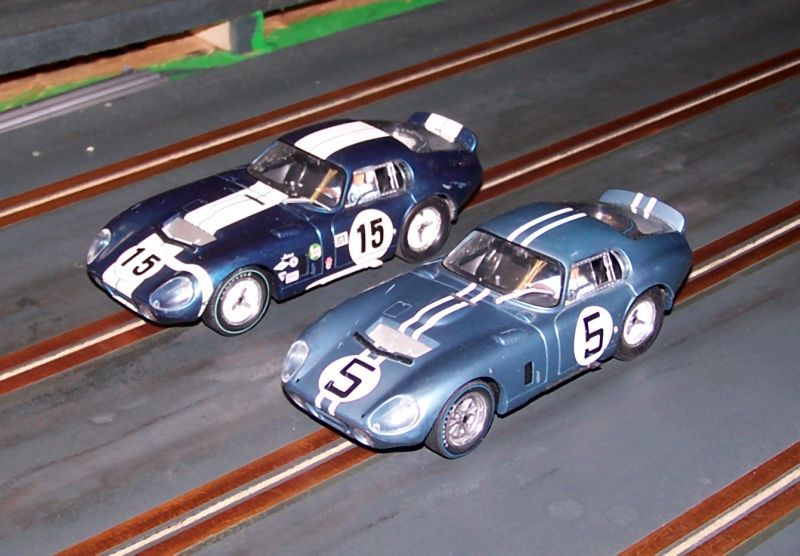

Since this is the weekend of the Rolex 24hr. race at Daytona I was playing with my two R/M Daytona Cobras this week. I purchased a couple pairs of Paul Gage tires for them and what a difference these tires make. I put a pair on my dark blue Cobra and left the original tires on the other. On the new mdf track the car with the PG (trued)tires cornered smoothly and accelerated out of the turns without excessive fish tailing. The other Cobra with the stock (trued) tires could hardly be controlled through the turns with any speed and would fish tail halfway down the main straight. I've had these cars for about two years and after adding some mag downforce they navigated my Scaley sport track like a couple of overweight tanks and therefore stayed on the shelf most of the time. I've seen some complaints online about their handling qualities and I agree that they are not at their best on plastic but are one of those cars that are really at home on wood with the right tires.

Bob, one quick "tuning fix" that will help these a little: remove the spare tire. That is a match to the fronts and it is a lot of weight to have that high up in the tail. If you are concerned with the cosmetics, one guy I know scanned the spare on his flat bed and printed out on cardstock then put that in the rear window.

By the way, removing that spare tire didn't make any real difference in any of the cars tested, no matter how they were tuned.

I swapped the motor for an M/T Resins M/T-1 motor, added a little weight, lowered it slightly, and added PG tires. Awesome car now. Glad you are having fun with it!
