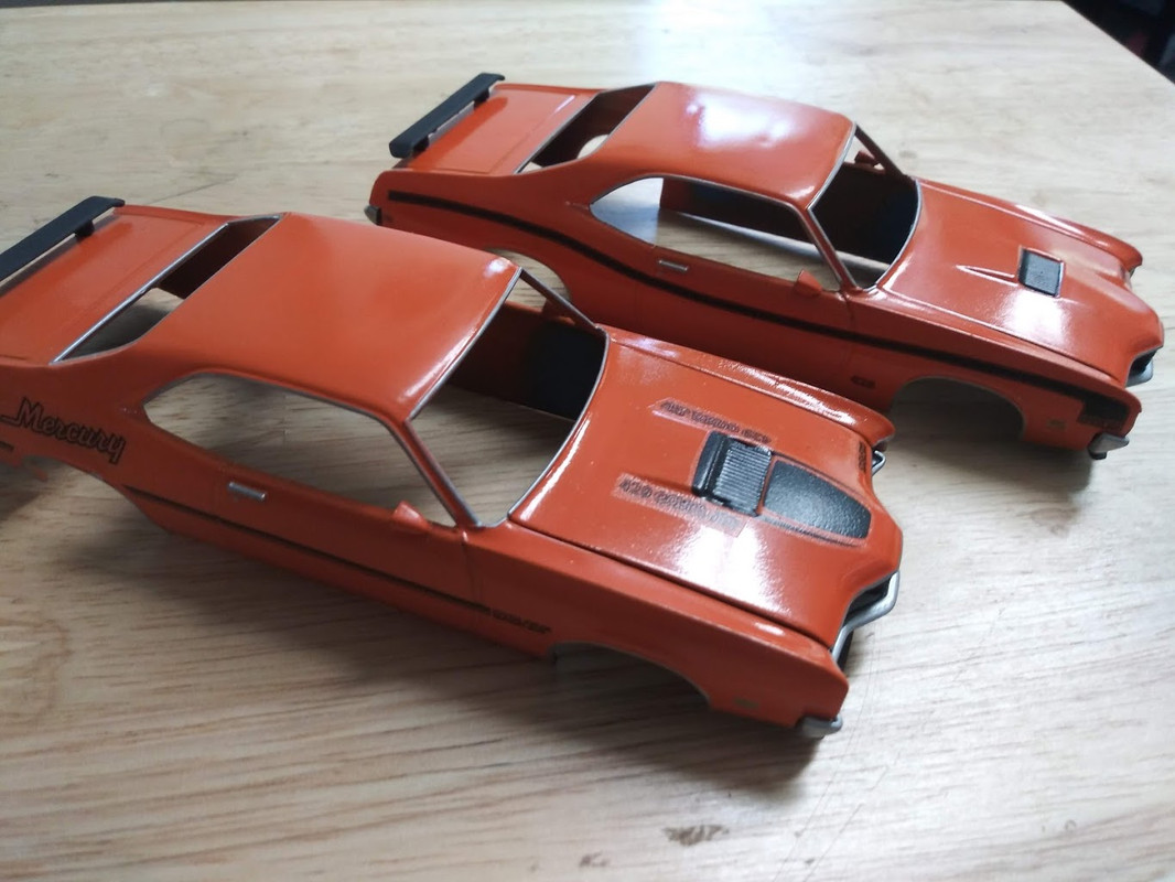

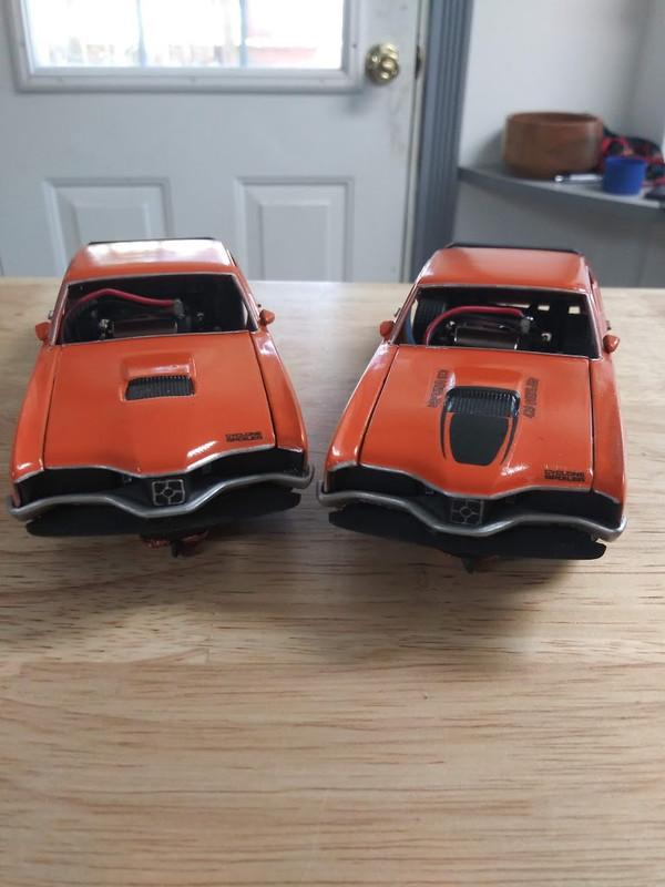

Postby proxieken » Fri Jul 19, 2019 9:38 am
Not trying to monopolize this thread with too many posts, but here are the first of my "pay my taxes" cars.
Tried to go with competition orange and went a little free-style with some of the decals on one of them. The hood scoop spears are a pain but look good if you get them on correctly.
Still the most ridiculous front in muscle car history.
Going to paint the drivers later today.
