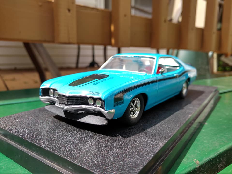

Mine is almost finished. I need to print the roof numbers, and some small details. I built mine in a fantasy livery.
I used an old Ninco Mercedes chassis ,trimmed to fit, and relocated the front axle a bit further forward. I used ACE brand Orange for the color. Wheels are CB design, Tires are my own. Motor is a typhoon 21,000, with 9/27 gearing, slotting plus guide, SCC braid. This is a great kit, i enjoyed building it

That looks pretty cool and just love the color. Gotta be the best looking orange I've ever seen.

That orange Cyclone has a nice shine to it. What did you use for a top coat?
Yes, the Proxie Cyclones are fun kits to build and can be used with a variety of chassis. Ken includes decals when shipping if you want to do a classic replica, or bring your creativity as Bob did and make your own livery.
