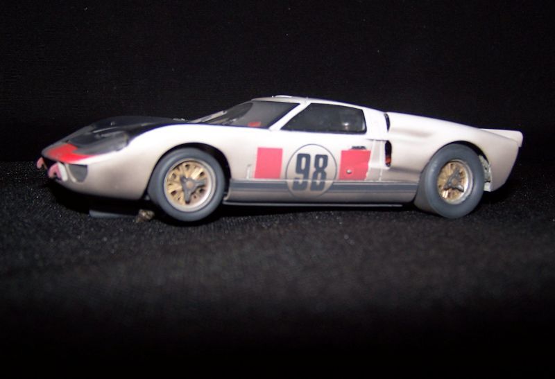

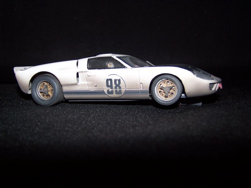

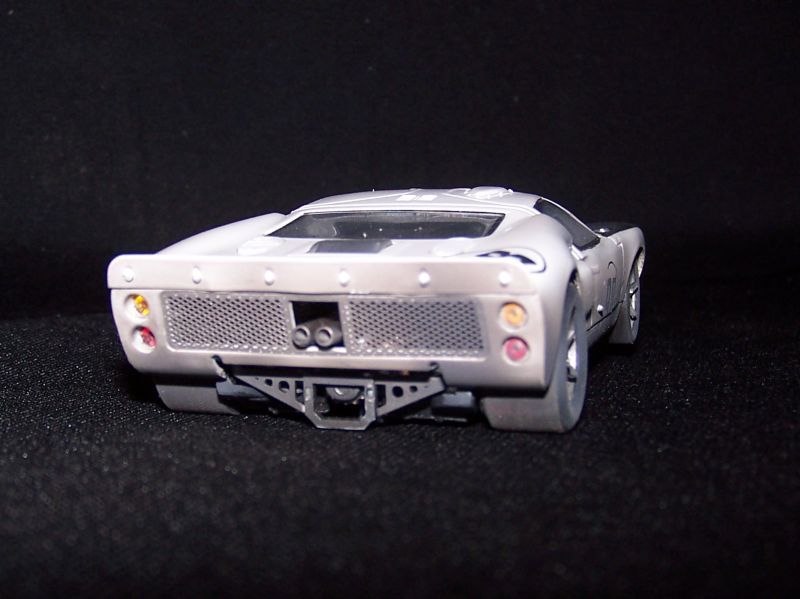

Since I recently acquired the definitive 1/32 model of the 1966 Daytona Continental winning Ford GT MkII from Slot.It I had in hand a good candidate for modification, being my Fly version of the same car. During my research about this car I happened across a photo of the three Fords that finished the race being loaded on a transporter for delivery to Sebring. They were all very grimy having collected a lot of soot during the race. So, after making a couple of modifications to the Fly model including the removal of the rear deck scoops and the orange bands on the right side door, I decided to add some significant weathering to the car. Here is the result.

Looks good, really adds a lot to the car.

Looks good. Race cars running that amount of time are never clean. There's always something around, dirt, rubber dust, rubber chunks, carbon from exhausts, brake dust, and assorted other nasties. Then it's worse if it rains. :)

Weathering boxcars was the reason I first bought an airbrush, and I think about doing it to slot cars all the time. I've only done it once, and that was a Porsche 962. The big reason I wanted to do it was to dirty up the area of the body where the exhausts come out. I didn't do the spray because they don't make the paints I used to use on RR stuff anymore. What did you use for that road spray look?

I used a Floquil railroad color you might be familiar with called grime. I use it to make exhaust stains on my WWII model planes and to grime up my HO steam locomotives. Thinned it about 50% before airbrushing.
