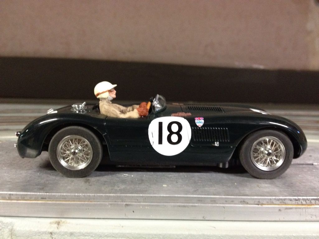

I have one and I am glad I grabbed it, great looking little car, the wheels are quite a treat, they are plastic press on but as best I can tell the spokes are etched metal.
Mine had already been setup by a pretty handy tuner (some how I managed to snaffle it from 50s ahead of you :) )
It has an NC1 motor in it - a must I think if it has the same AA motor as the Mustang (I have one of them as well that goes fine). The body has been lowered, and Glen put a proper sized driver in it. I will take some photos and post them later. I am pretty sure he left the stock gear on the back which I think is 27t I am thinking of dropping that back to a 24t or 25t to have a 9/25 - will experiment and see how it goes. I have a 9/24 in my Lancia D50 and it goes well.
The sides of the chassis have been sanded for a bit of body float. I am thinking about moving the exhaust pipe and attaching it to the body. that might allow a bit more float. Glen put about an inch square of lead in the middle of the chassis just behind the motor. He also has a bit of tubing on the motor chaft to replace the spring.

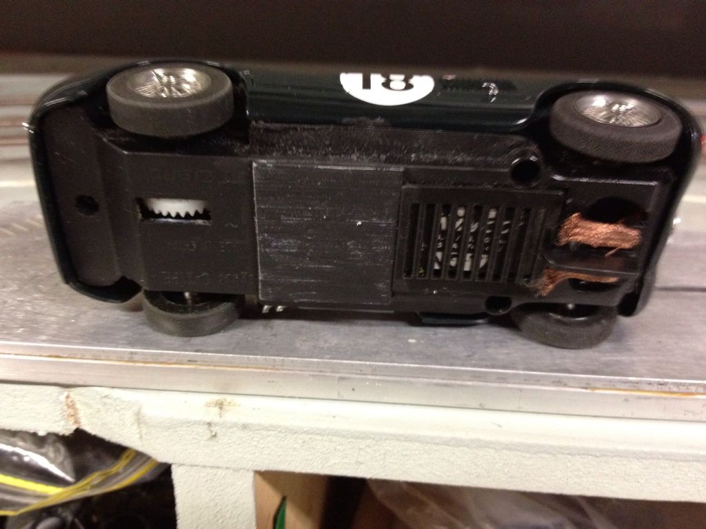

Jeremy sorry I was late. I have mine running pretty well right now. I too went with the NC-1 but M/T motor would be perfect as well. I removed all the lights, removed fender wells, replaced spring on motor shaft with pen tube, replaced plastic pinion with brass and I put my weight right behind the rear wheels on either side of the back body screw. I also used SCC silicone tires in the rear and Ninco tires in the front. I trued the tires and polished the gears. After seeing Dangermouse's I will replace the driver and lower it some. As she stands she will run with the Ninco classics. Good luck Jim

Swapped an NC-1 into mine, took out the guide spring and that was about all I did to mine to match it up with my other Ninco classics. The original rear tires are very skinny but hooked up surprisingly well on my routed track. Swapped a mrrc driver into the cockpit that helped looks considerably. My experience is that after a motor swap for more realistic speed these cars don't require much else.

Don't have mine close by to check but I may have hot glued the bushings and might have added superglue to the inner bushings as well. Noise is not a problem even without custom parts. Ninco classics run well on my track even with stock rubber. And the C-type keeps up with most any of them just fine with it's stock tires.
