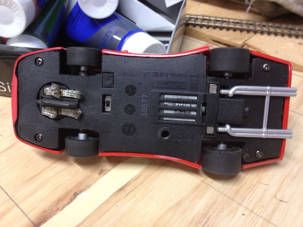

Postby Dangermouse » Fri Mar 08, 2013 7:48 pm
I would go for the 512 - and the newer one eg NART #64 in preference over the older style chassis
I have sanded the edges to allow a bit of body float
It weighs 104g - I am pretty sure I have some lead in it

Postby Czar » Fri Mar 08, 2013 8:41 pm
Dangermouse, do you get enough float with that tiny bit of clearance? I have seen several of your builds and I respect your skills. But that just looks like a minuscule amount of clearance between the body and chassis.

Postby Dangermouse » Fri Mar 08, 2013 11:16 pm
czar
Its ok - but it is a work in progress :) I find with Carrera cars first thing to do is remove any snag points on the chassis that rub against the body - they have lots of extra bits on the chassis. I then gradually shave away from around the edges. There isn't a lot on the side sills off this one be the next area I hit but the ~1 mm or so is enough around the front and back.
I have two of these and haven't raced this one yet ... on my other car I have a bit more clearance all round I have also put two pieces of lead (probably about 5g total) on either side of the little switch - seems to balance the car out nicely.
I have two of the Carrera 599xx onone I took about 2mm all the way around and lowered it and the other I just removed the internal snag points, sanded the edges and lowered it, they both drive about the same - fun to experiment and see what works and doesn't
