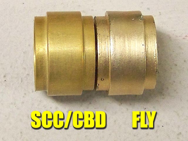

A hubless SCC CB Design 15x10 is the wheel you want to use if you go that route sir.

Thanks for the detailed feedback and suggestions guys. I'll have another go at it and try to get that back end sorted with Slot.It parts. I had just planned on gluing the plastic Fly wheels to the axle, and I may still do that short-term.
Thanks Harry for that photo of the CB Design Wheels, and I very much appreciate your giving me the part number along with that. I don't own a micrometer, and not knowing exactly what size I needed had stopped me in the past from buying aftermarket wheels. This is a big help, as is that tip to use sandpaper on the existing Fly axle and motor to eliminate the knurling.
