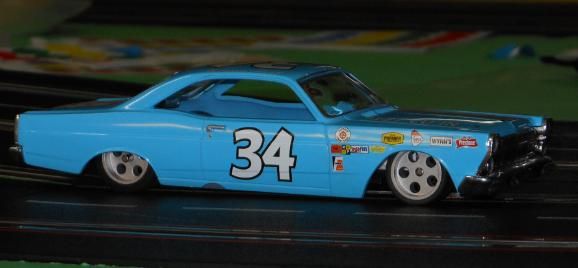

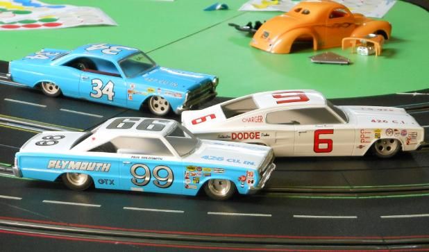

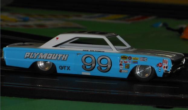

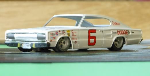

As stated in another post, I was just getting tired of trying to get my monogram classic nascars and my scalextric trans-ams to run the way I wanted. At my local hobby shop I got a good price on some slot-it HRS chassies. So i took my scally mustang and camaro and went to work. Carved out the wheelwells, removed the glass except for the windshield, no bumbers and other stuff youd see at your local short track. Not sure how I will do the interior yet as there is not much room left. I'll have to get HRS 2 chassies for the monograms do to long wheelbases. Will post pics soon, have to replace harddrive on my good computer..LOL.

Thanks for the pics of the brass chassie. I guess I should have been more clear what I mean by run the way that I wanted. At heart I am a speed freak. I like my cars to run fast. My fave class to run is run what you brung. Not so wild about box stock racing. Dave, I have done alot of tuning to the monograms. I have done all of Harrys tuning plus laid down the motor and other stuff. There running slot it motors, gears, axles, rims. NSR tires. They run alot better than they did stock. Pretty much the same for the scallys. I just do not see them running with slot-its or NSRs on the stock chassies. I also like the way I can change motor lay out with the HRS chassie. All I am doing at this point is buying the HRS starter kits and moving the hard parts over to it. They will rum mostly on wood tracks. Some how I see most of my scallys and monograms going this rout. Going to have to see about building some brass chassies, looks like some fun....
