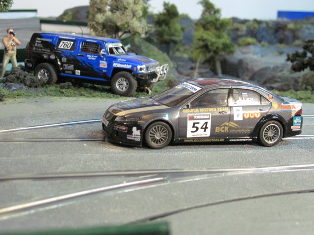

I'm a big fan of these cars... They can be quite a treat when sorted, as you have found...
A pic from a proxy race one of mine is in currently...

Yes!!!
Thats the "Russian" livery Accord that Mick and I were talking about in the other thread....
....Do I need another slot car?????
This hobby sux sometimes :P
Rob, I totally agree regarding the price on some of the aftermarket wheels out there. I normally don't do the aftermarket wheel thing, preferring to use stock components on my tune-ups (rear tyres being the general exception).
This was a bit of a "special" for me though, I love the model (yes, warts and all), its a slot car I can relate to, but I did think long and hard before spending nearly as much on a set of wheels as the car itself....
Besides, the stock wheels were just hideous!!!! I had one hub crack when I initially stripped it down some months back, so I thought blow it, I will make this one a bit special.
I'm glad I did, the little Honda is a blast to run, very, very stable, something it wasn't before on untrued plastic rims....
