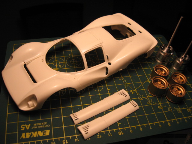

Was poking through my slot car closet and came up with an old Fujimi Ferrari 330 P4 model kit.
Was incomplete but had all the needed parts (body, glass, interior dash, wheels) for a slot car conversion. BRM aluminum 1/24 rims and my own cast urethane tires are the right diameter so that's the rolling stock.
Thinking of a sidewinder motor layout for this one.

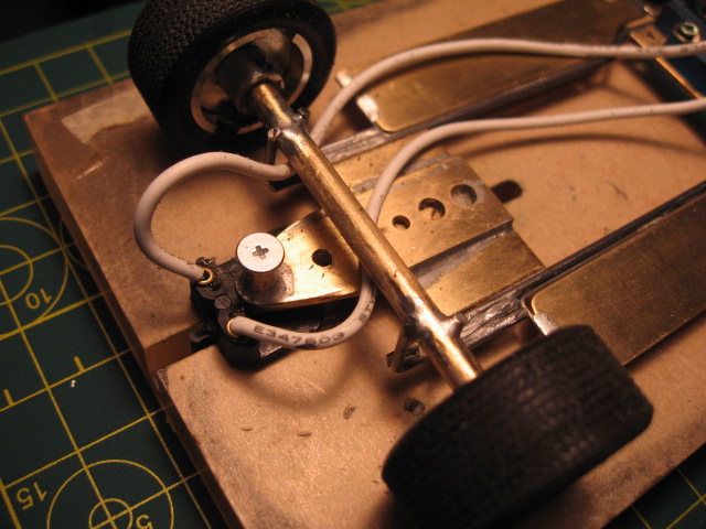

Cut, trimmed and assembled chassis parts.
- .055" piano wire for main rails and front axle uprights
- .064" brass strip for guide tongue and crossmembers
- 4mm brass tube for front axle holder
- 5/32" brass tube for guide post
- Scale Auto 3mm axles
- Sloting Plus 3mm rear axle bushings
- BRM 1/24 Trans Am front and rear aluminum rims with home made urethane tires
- 3DRon sidewinder S can motor mount
- Slot It 11t 6.5mm pinion gear
- Scalextric Sport spur gear, 35t

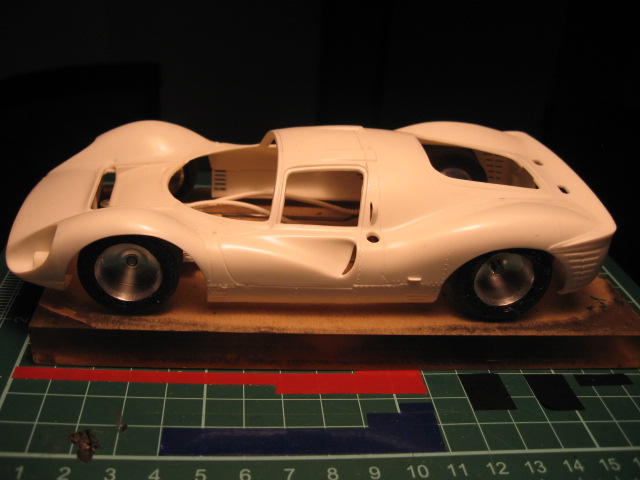

Shaped kit's wheels to fit the BRM rims.
Should be rolling soon.

Chassis's rolling and powered with a Slot It 25K S can motor.
Changed gears to a 10t, 6.5mm pinion and 34t, 18mm crown. Mesh was better with a combined gear distance of 24.5mm (6.5mm + 18mm). The Scalextric Sport sidewider gears are different diameters with the 34t being the only 18mm diameter one.
Was going to true the tires but discovered that my old Tire Razor axle pulley doesn't accept a 3mm axle. Ran with untrued tires and it drove nice and smooth. Pleased with that outcome.
Mocked the body for desired stance. Going to work out.
Fortunately the incomplete model kit did have the decals so I'm covered there.

Added chassis .032" flexi side pans so as to side mount the body along with a single front post, just under the guide, for a tri-post set up.
Stance is good not slammed right down at all.
