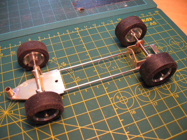

So, gathered pieces including,
- .055" piano wire for main rails and front axle uprights
- .032"x .75" brass strip for rear and middle crossmembers
- .032" x .75" brass strip for side pans
- .064" x .75" brass strip for guide tongue
- 4mm brass tube for axle tube
- Plafit/Sigma 28t crown gear for 3mm axle
- Scale Auto 3mm axles
- Sloting Plus 3mm rear axle bushings
- JK F1 motor pod (.75" wide)
- Samson guide post
- BRM 1/24 Trans Am front and rear aluminum rims with home made urethane tires
Should be rolling soon.
Dan
VTECFOUR
Posts: 1208
Re: AMT McLaren Elva
Postby VTECFOUR » Thu Apr 11, 2019 4:39 pm
Assembled the basic ladder chassis.
Mock fitted the body.
Final stance will be close.
