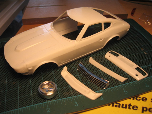

Letting the paint dry on my 1/32 Ferrari 312P Coupe body, so opportune time to start on the next car on the build list, a BRE Datsun 240Z.

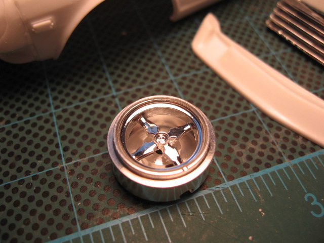

Had this 1/25 Revell re-issue for a couple of years so pulled out the bits and instruction list to begin conversion. Thought it'd be a one-piece body, but not so. Starting to get it solid by gluing the front valence, hood and headlight covers to the main body.
Cut down the wheel inserts to fit CB Design 17 x 8 inserts wheels.
Want to include as much of the kit's interior so building a hybrid sidewinder chassis using a Slot It motor pod.

- cast cut down wheel inserts for CB Design 17 x 8 insert rims

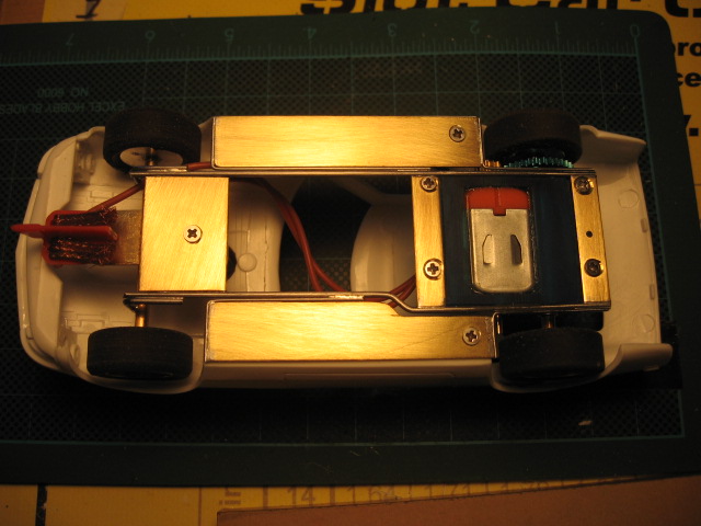

- assembled .055" piano wire and .064" brass strips for a hybrid chassis using a Slot It sidewinder motor pod. Trying out a Samson guide post for the first time.

Basic hybrid chassis assembled. Ended up using a 3DRon sidewinder S can printed motor pod with zero axle offset. Trued PG 210805 tires, the fronts slightly smaller in diameter than the rear.

Chassis's assembled and running.
Motorized with a Slot It 21.5K orange bell S can with Slot It 11t pinion and 34t crown gears.
Drives fine but we'll see how it does with a mounted body. That's next.

After much Dremel sawing and grinding, got to attach the remaining platform onto the rear of 3DRon motor pod.
The mock up works. Doesn't interfere with the gears and wheels and the body mounting posts position cleanly onto the chassis.
