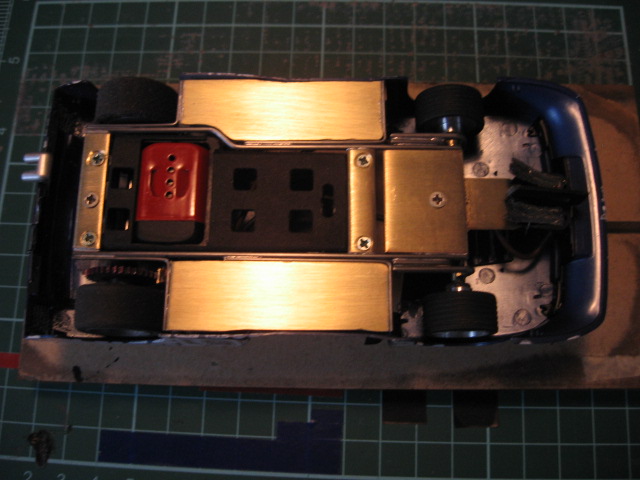

Added some flexi .032" brass side pans and tuning lead.
Noticeably improved handling and driveability.
Body mounting's next.

In the meantime, the body's mounted. Worked out nicely with the sidepans flush with the sills...
...and having a good stance.

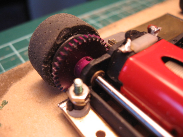

My rear track was as narrow as I could get and didn't allow the wheels/tires to be tucked within the body. Then I remembered chrisguyw's trick of modifying the Slot It sidewinder motor pod by replacing the spherical bushings and holders with Parma oilites. That would give me the extra narrowing millimeters.
Worked a treat with the wheels/tires easily tucked in now. Thanks Chris.
Quite pleased with the outcome.

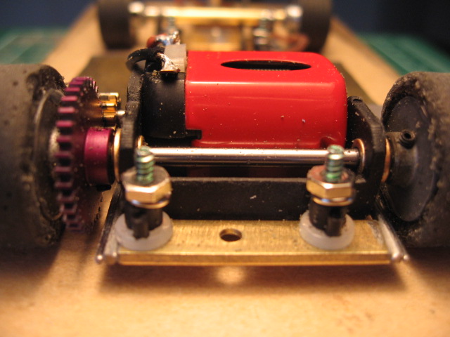

Made two changes. Went from a single rear body post to two single ones attached to each chassis side pan.
Placed motor pod urethane washers between the chassis and pod and locked attachment screws with nyloc nuts for minute adjustments.
Side body screws and rear motor mount nylocs were set loose and got some big improvements.
Fastest lap went from 5.814 seconds to 5.614. Two tenths is a big change. The car is quieter too, no doubt the use of urethane washers for body and motor mounts were the reasons.
Nice to see it perform as originally hoped for.
