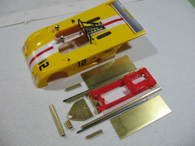

The Sloter Lola T280/90s offered quite awhile ago were one of my favorite cars. Pulled one out recently and it seemed a bit sluggish compared to the Slot It Alfa Romeo T33. Time for a re-chassis, one of my adjust-o-wheelbase ones that work really well under a small body.
Cut and shaped the usual materials for assembly.
- .064" brass guide tongue
- 5/32" brass guide post tube
- 1/8" brass front axle tube
- 3/32" brass square front axle supports
- 3/32" brass square tube main rails
- .064" brass front cross member
- .064" brass rear cross member
- .032" brass side pans
- .062" piano wire front assembly sliders
Will be motorized with a slimline FF050 motor held in a 3d printed motor pod.
Chassis assembly won't take long.
Sure nice having an body already done as modeling from scratch takes me a lot longer than building just a chassis.
