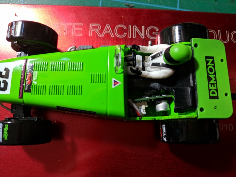

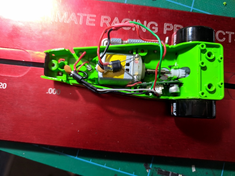

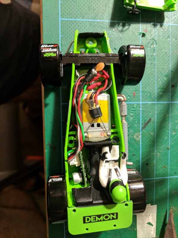

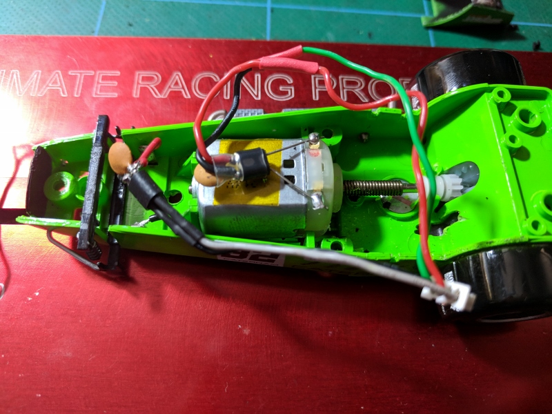

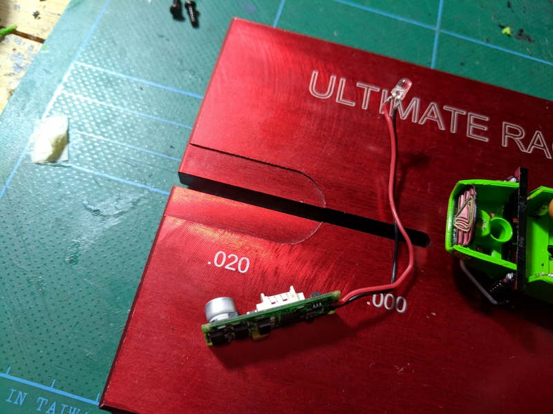

This is how I have chipped mine:
I used one of the scalex F1 DPR chips. After removing the plastic cover these are the smallest chips in the market right now.
I also put the IR led on leads.
I soldered the wiring loom from one of the scalex gokarts so that I can use the 4-pin plug to connect the chip.
I installed the chip near the driver (this requires material removal from the passenger seat.
But once you put on the seat cover the chip is not visible anymore.
As you can see, with such a small chip is already a struggle.
If carrera does a chip with a similar footprint then you might be able to fit in this car.
