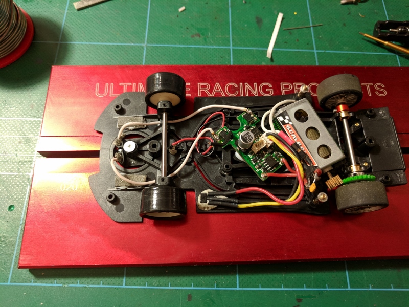

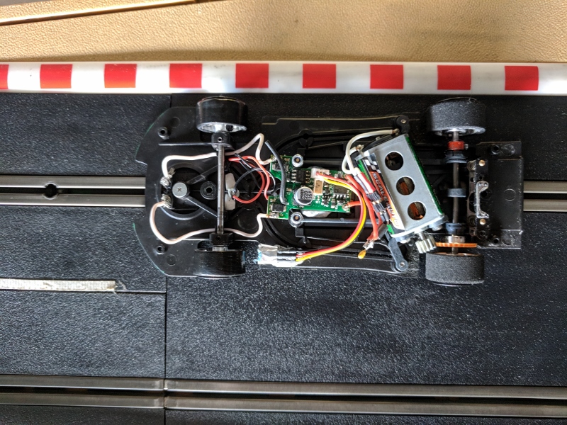

Postby GRUNZ » Tue May 01, 2018 1:51 pm
Here are two options on how I have chipped mine with an oXigen chip.
The first one is using the standard pod that comes with the car:
The second option is with a Slot.it pod:
I think that there is plenty of space for a standard carrera chip.
