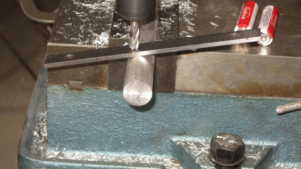

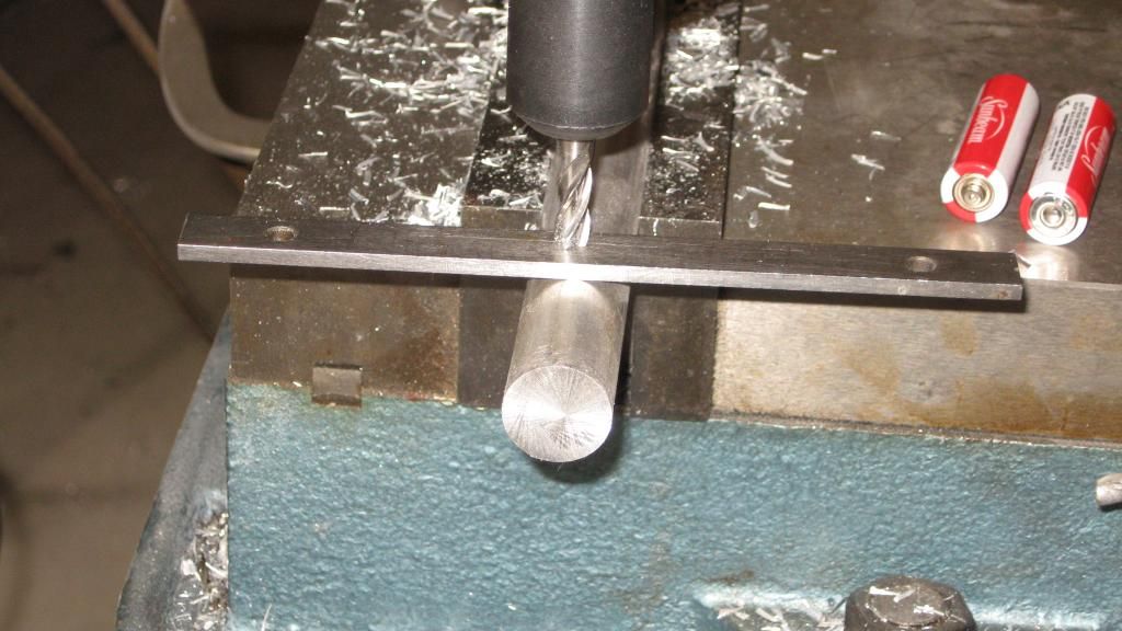

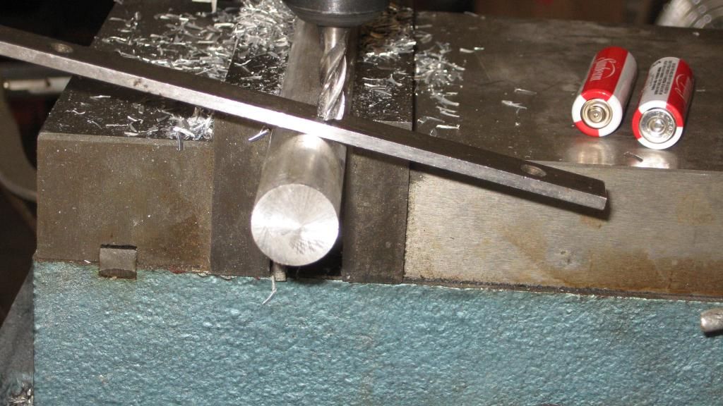

with your bar in a vise, and POWER OFF, lower the bit onto the steel scale
If your bit is to far back the scale will tip up in front, if its to far forward the scale will tip down in the front
when the bit is centered on the bar the scale will sit 90 degree

Jon - thanks for that - I thought it worked that way but your pictures are excellent!

Nice visual aid! :)
