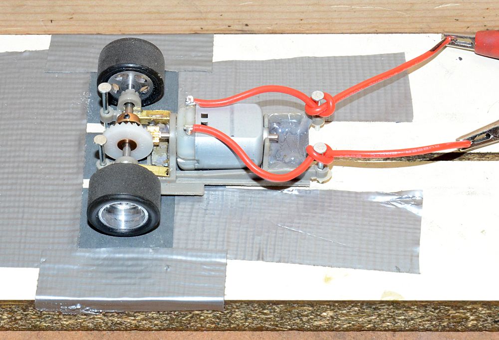

I recently had an incident with Loctite, the details aren't important, but I needed a station were I could break in a motor when needed. I had a piece of maple that was a stain sample from our kitchen remodel and figured it would work.
So far so good.

Postby HomeRacingWorld » Sun Aug 23, 2015 7:15 pm
Very nicely done sir. I cannot wait for your clinic at the event. I'm gonna get smart in a hurry.

Postby TuscoTodd » Sun Aug 23, 2015 8:42 pm
That is both a slick design and VERY nicely done!
Thank you for sharing the pictures!

Postby waaytoomuchintothis » Mon Aug 24, 2015 10:19 am
Am I misunderstanding the photo or is that also a gearing wear-in?

Postby waaytoomuchintothis » Mon Aug 24, 2015 12:12 pm
If you smear the gear teeth with Tamiya Coarse Polishing Compound, you will get silky smooth gears in a few seconds. I use it on all cars I make chassis for.

Postby RichD » Fri Sep 25, 2015 7:41 am
I did not want to scuff in tires while they were on the car so I built this. I also have a skid pad made of Ninco track.

Postby RichD » Tue Sep 29, 2015 7:40 am
If the tires are really true it does not hop, so using this rig to polish the tires is a good test. I was thinking about adding some very light springs in the back, but those would mask the hop.
