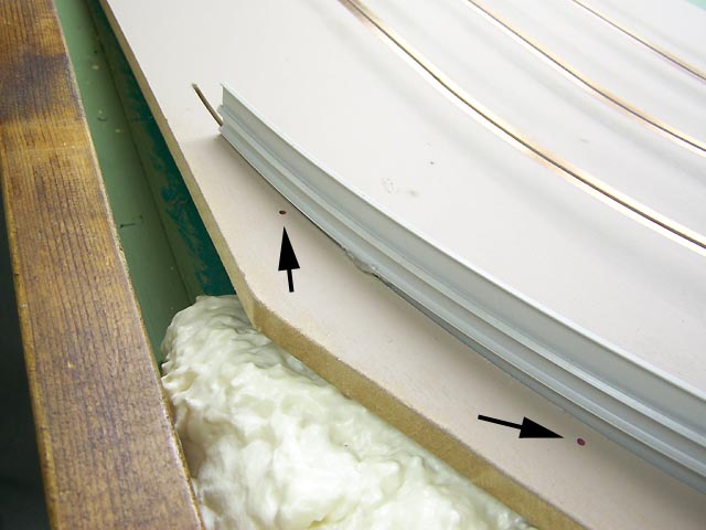

Did you route an extra slot for wall mounting?
Or just going to add them around the table sides?
For walls/table sides, some 1x6 lumber would work great.
I like vinyl screen cap along with gutter guard fence for walls that are mounted around the curves.

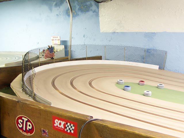

Postby HomeRacingWorld » Fri Nov 09, 2012 1:07 pm
About 6 inches.

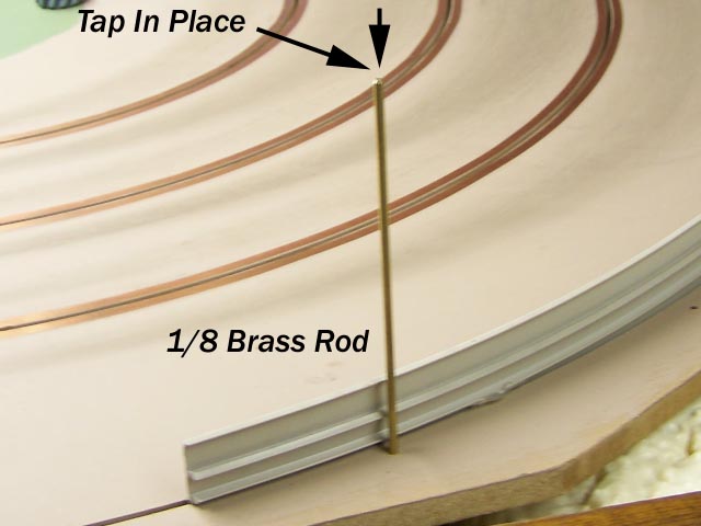

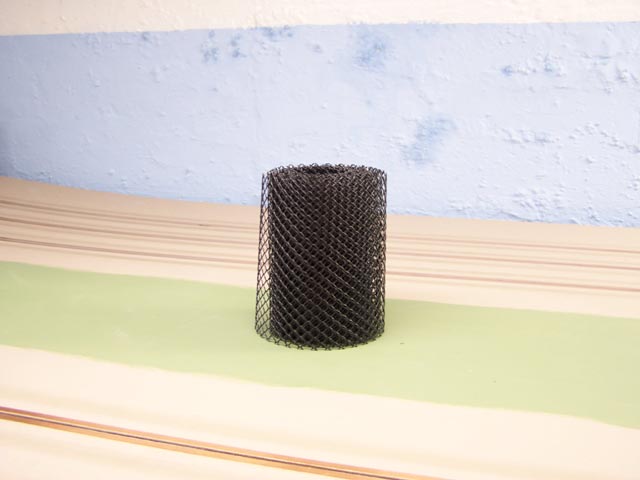

I use Plastic gutter guard
After installing the screen cap in the slot, I drill pilot holes for the fence poles
I tap in 1/8 rod.
Use craft wire to mount the gutter guard to the poles. Pretty easy, it REALLY works keeping the cars inside and it looks realistic enough for me.
