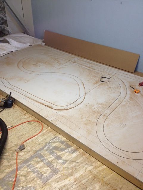

Well...here is where I am today !!! 2 lane routed track...11' x 5'4". I used the plastics from LUF and the router bits from SCC. All worked great!
Sanding this weekend and hopefully applying the copper tape next week.
Awaiting many part to fuel this project from the fine guys at SCC.
PLEASE insert comment/ideas !!
Thanks to all those great people who helped me get to this point !

On the left side there it looks like a pretty tight kink there??? Do the guides clear that ok?
But great job on your first attempt sir, I knew you could tackle it. :text-bravo:

The kink area the other lads are talking about may cause stress to, the guide assembly , even if the guide fits through ok. It depends on how fast that part of the circuit is combined with the sudden change in direction.
Otherwise I think, its a great design with nice flow.

Great job Bobby, very nice! I would echo the comments about the kink. Scalex guides may fit fine, other cars and guides could eventually have issues because of larger guides. It's a pretty abrupt transition and will kick the cars around a bit. If you want it smooth, a little bondo and a re-route is easy now (I did that twice on my track). If you want the challenge of "driving" that point of the track, then leave it as-is. The best tracks are running tracks, no matter if they have kinks or not.
Looking forward to seeing it running! Good job!

After reading the comments regarding the "kink", I am considering routing that area again. How long does it take Bondo to cure ?

Also...can someone link the specific Bondo product that I should use on MDF ? TY !
Home Depot has a few choices and I am uncertain on which to use.
bobbyraz49
Posts: 726
Re: My 1st attempt at routing a track....
Postby woodman » Sat Apr 26, 2014 6:53 pm
This is what I have used for years...Even the cabinet shops use it when doing plastic laminate work, sticks to MDF and Partical board and anything else....The speed it dries is really fast when it is warm....
