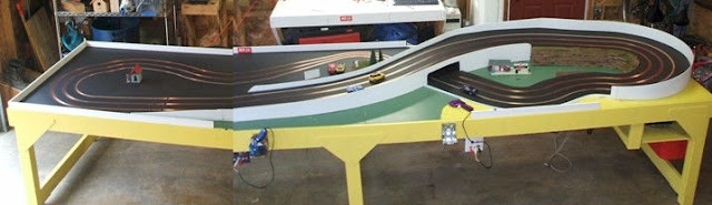

Re: Is it possible to create an interesting 3'x10' 3lanes tr
Postby Junior » Tue Jan 28, 2014 7:26 pm
This is my main track, it is 4' X 16". The track design is a modified version of the Suzuka track from the Slot Car Bible.
Junior
Shop Teacher
Posts: 617
Postby demether » Wed Jan 29, 2014 5:34 am
thanks,
Yes, it's this kind of track I'd like to build. I'll search for infos on how you make the bridge connection, it sounds a bit tricky.
